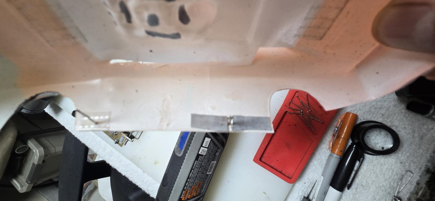

Hey John; from what I've been told the issue is guys running .010" bodies and painting them up to the minimum specs, including spraying clear on the inside over the windows, and putting lead tape on the bodies to get them to weight.
  • JerseyJohn likes this
#33 Danny Zona
Danny Zona
  • 1,565 posts
  • Joined: 27-July 12
Posted 26 March 2026 - 08:14 PM
About a half gram added to both sides.
