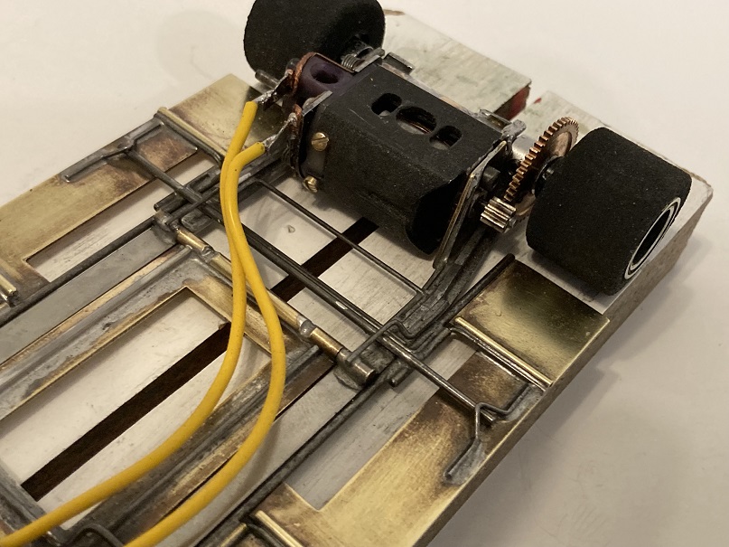

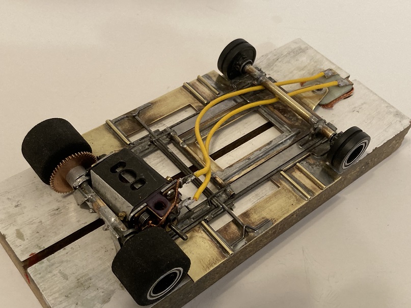

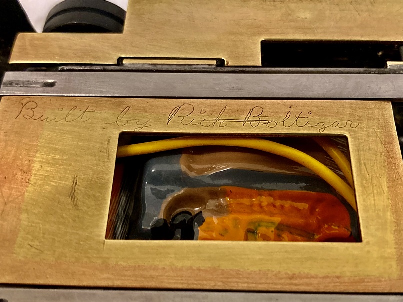

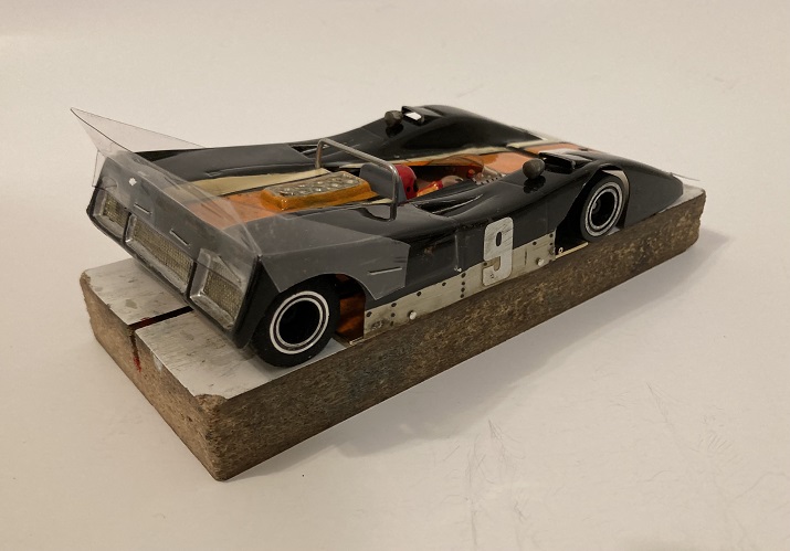

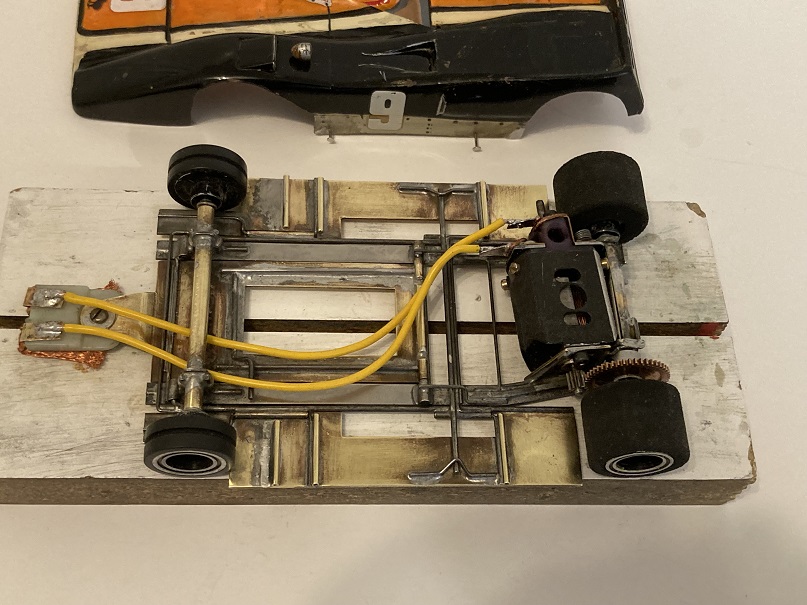

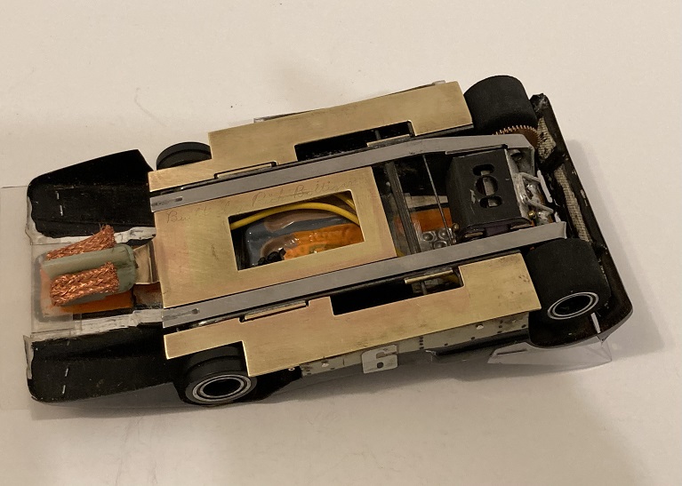

Rick (dc-65x) was kind enough to send me a pro slot car project to complete.  A 1971 Boltizar steel main rail chassis, a Rick (dc-65x)-built Champion C can motor and Faas gears were sent.

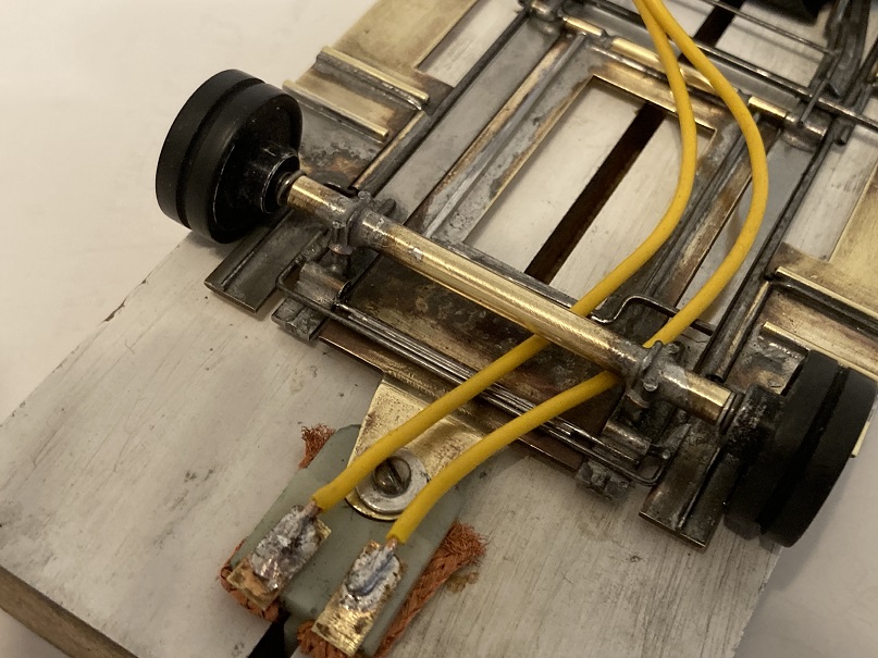

The car has been completed.  The chassis was repaired and cleaned up.  Riggen wheels were added.  Rear tires are natural rubber.  Original tires would have been orange.  The cool Champion motor Rick built now has an NCC20 armature.  The open armature was too much for the test track or the local hill-climb track.  Marklin train wire is no longer available locally, so modern lead wire is used for now.

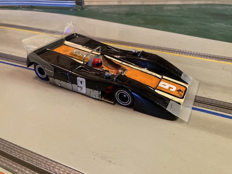

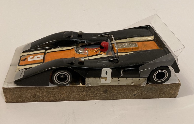

Eric and I felt the body should be a McLaren M8 since Kirby Ferrari 612s are rare.  Victor supplied the wonderfully-painted McLaren body.  NCC air control was added.  The interior is from A B Slot Cars.
Eric commented that the steel main rail chassis is very well-built, and there is little chassis flex.  It looks like it was built for a Blue King (large track) and lots of tire glue.  Time for a track test.
Plastic for NCC air control
NCC air control added.

Great restoration job Rod! In the '70s, Rick often came up to Connecticut to race with us on the C&C Blue King in Coventry. I made a jig for turning down the can sides on my Unimat. Adding a middle slot or hole to the top & bottom was as important to changing the magnetic field as thinning the can sides.

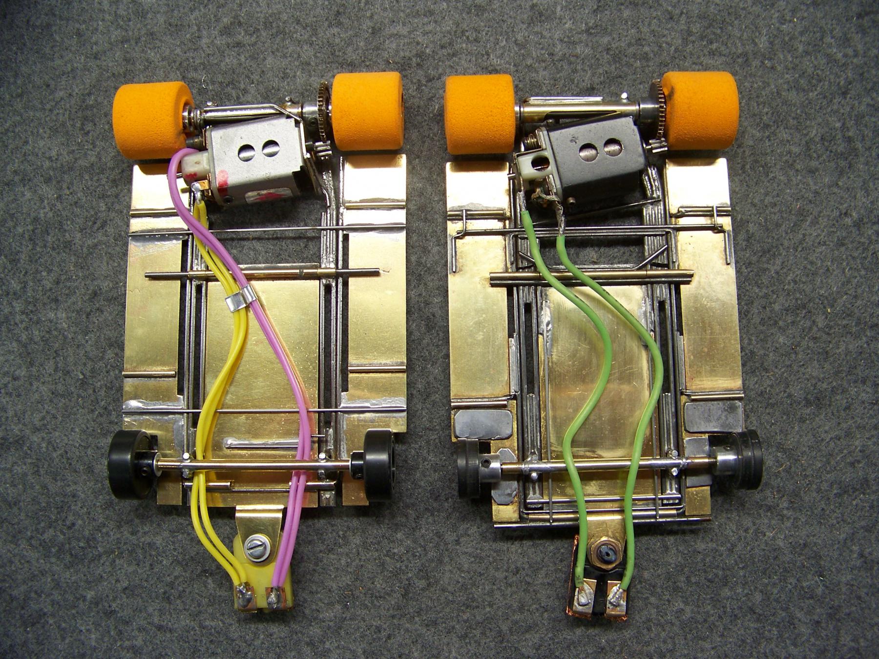

The backstory:
Quite a few years ago fellow Slotblogger "JAZ" (Jeff Morris) sent me the Boltizar chassis and a later (1984) Ray Kallio "wing car" chassis.
I had always planned on restoring these cars but I finally realized that my friend Rodney would do them the most justice with his period correct techniques.
Thanks Rodney for bringing both the racers back to life.    :good:

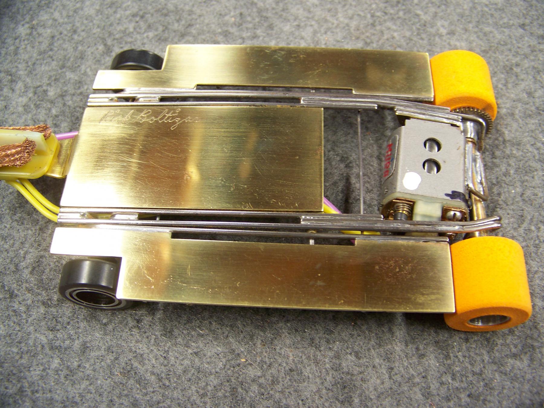

Nice car Rodney,

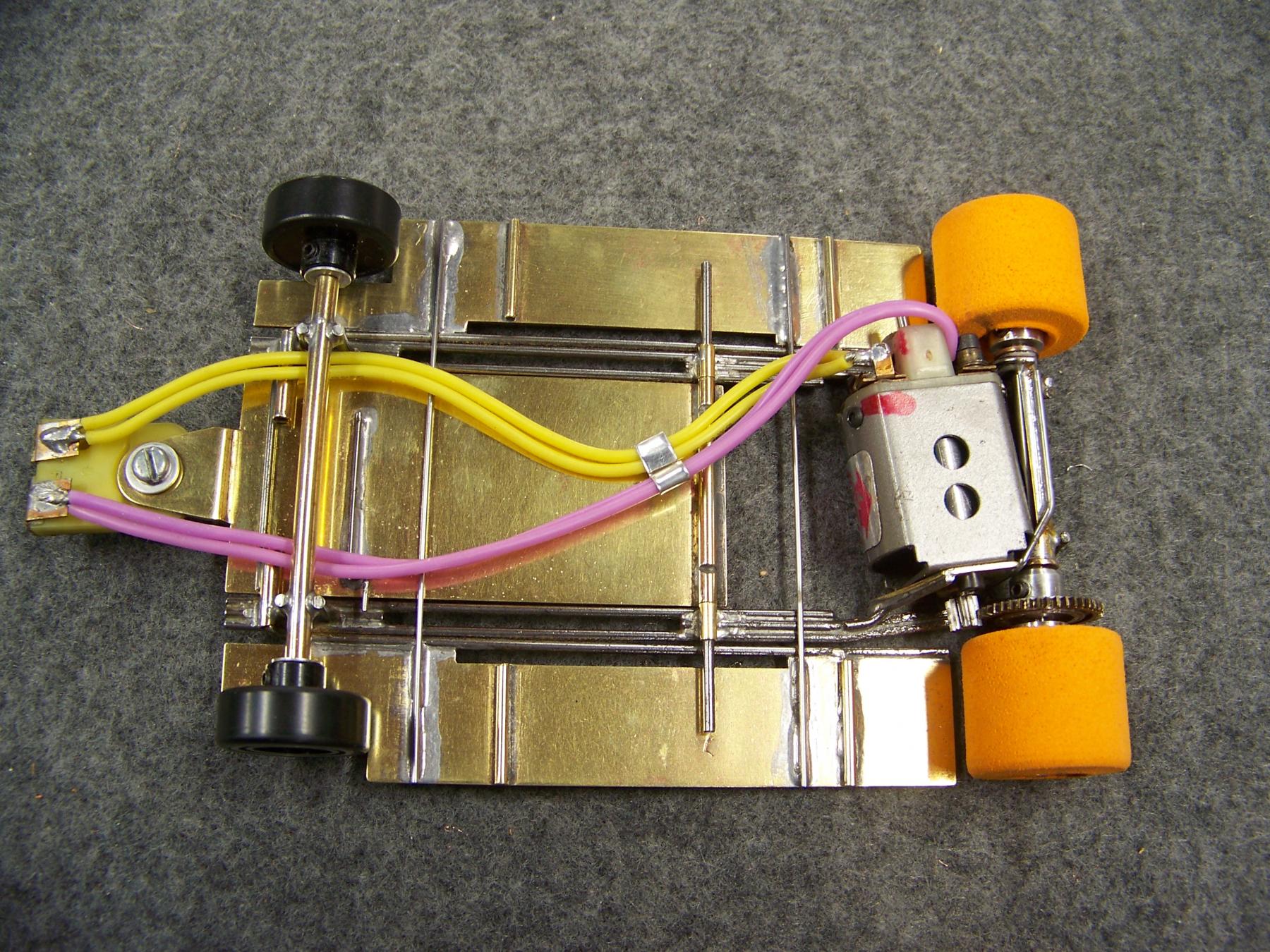

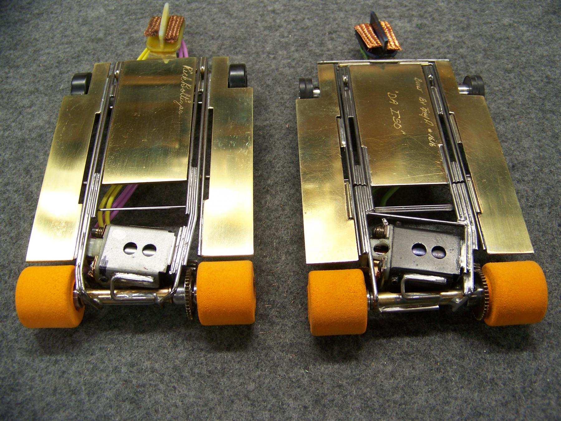

Hopefully not to distract from your restoration but I did a Rich Boltizar chassis for  Nicky, who found this chassis in the Buzz's basement.
Thought it might be of interest and some build similarities even though I assume the one I did is earlier?
  • MSwiss and Tex like this

Thanks for the background information, Rick.  Good to see another Boltizar chassis, Martin.  Eric and I think the chassis you restored is newer with no floppy pans.  Bill, I also ran Group arms in my open set-ups.

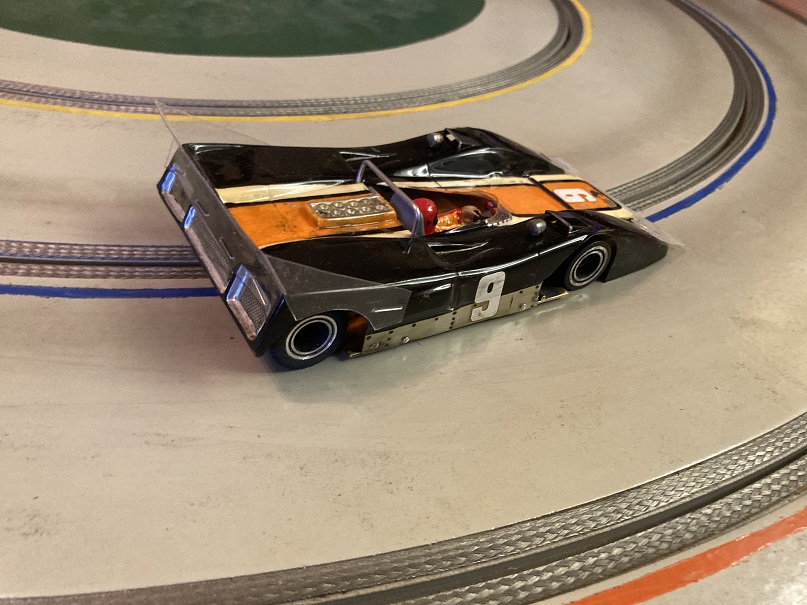

Track Test:
The car is very easy to drive, and the handling is surprisingly neutral, even when pushed.  Eric thinks the NCC 20 power is perfect given low track glue conditions.
  • Pablo, Jencar17 and Tex like this

#11 Martin
  • 4,671 posts
Posted 03 June 2026 - 06:43 PM
"Good to see another Boltizar chassis"
indeed, I had not herd of Rich Bolltizar before Nicky told me about him as an east coast chassis builder. Nicky who had close ties to Buzz's and even worked there. That basement was a time capsule, and I restored a handful of chassis from there, all signed. All in bad  shape.
What year did floppy's fall out of fashion?
Good to see this one on the track  :good:

For your viewing pleasure here is the Tony P "Da Iso" next to the Boltizar chassis.
Bill, I do have a the TonyP Tripod chassis as found if anybody wants to see it.
Rodney please P.M. me if this is taking away from your post?
