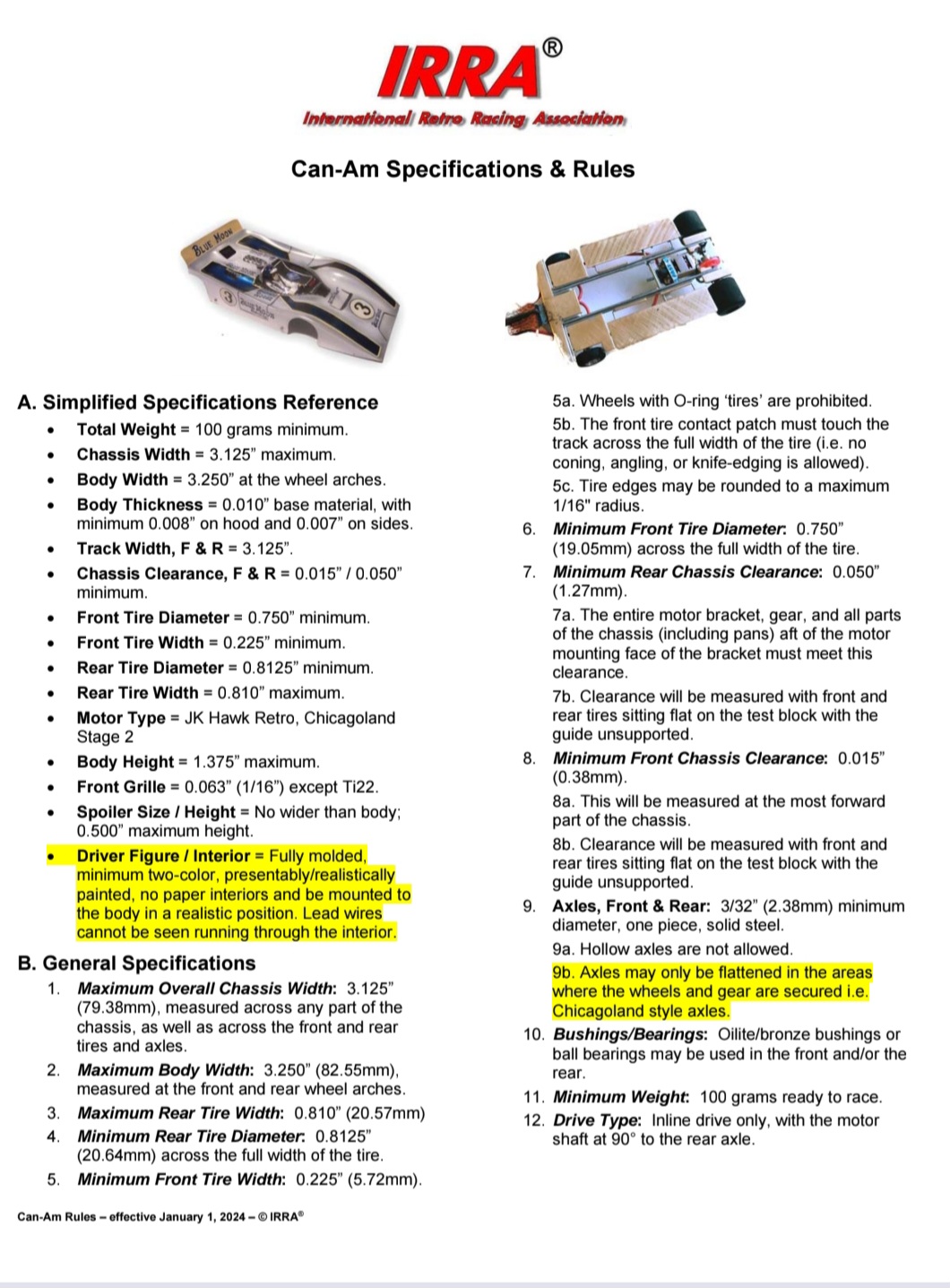

100% legal to narrow rear tires.
Front tires need to meet the minimum width for can am/coupe at .225" and .375" for F1 and Stock Car. Tires cannot be coned, knifed, or angled.

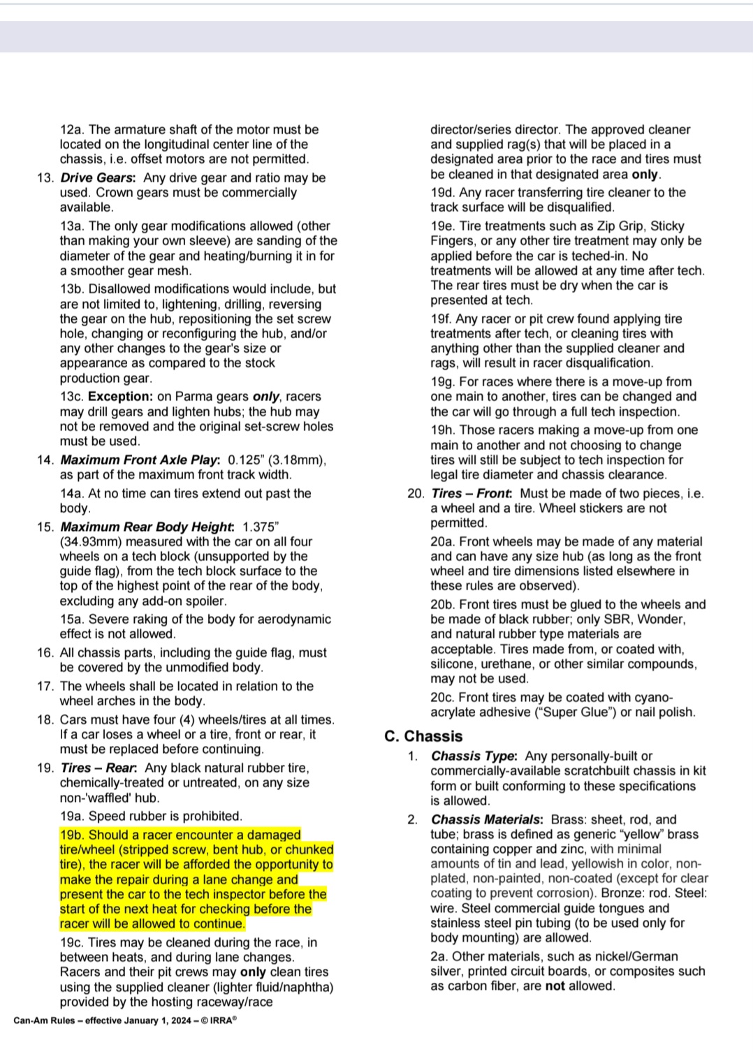

Mid-race tuning like tire or spoiler trimming is still above my ability and knowledge.
Tires cannot be trimmed mid-race in a Retro race. Spoiler adjustment are common.
If that's the case, I missed it for 18 years.
I can't even imagine why we would have made that rule.
