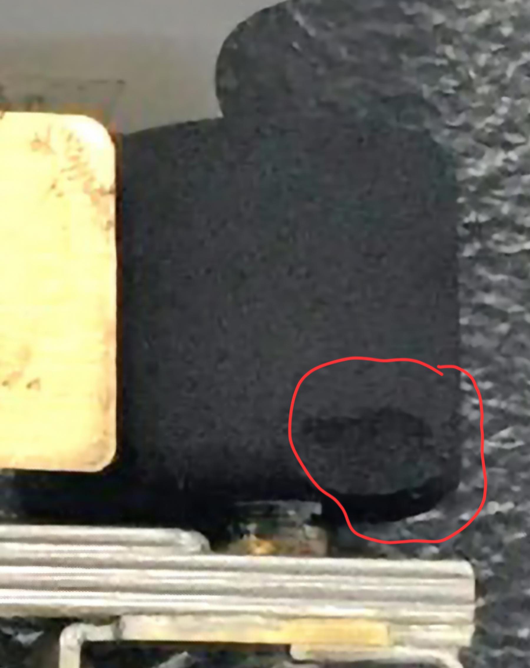

#37 MSwiss
  • 26,217 posts
Posted 23 June 2026 - 05:09 PM

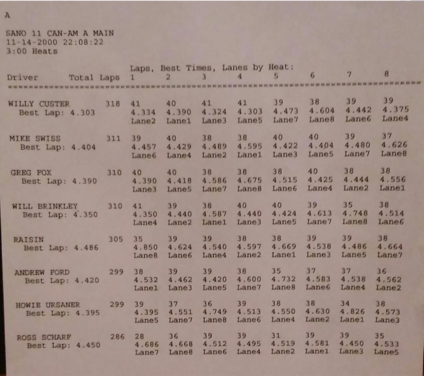

Yes, while spinning the tires on a power supply, and using an X-Acto is neater, using scissors is quicker and safer. I snip it and then I rotate the rear end approximately 180 degrees and snip it again to try to maintain reasonable balance.
From the results below, you can see I 'won' the second half of the race. Granted, Willy had a big lead and was probably on cruise, but more important, I did it on green and again on blue, and moved from fourth to second.
The technique was something I came up from my wing car days, helping guys out in qualifying, when they were hopelessly bogged and popping in the glue or stuttering around the donut. I came up with scissors for speed after realizing cars with chunked tires usually ran adequately in the race.
