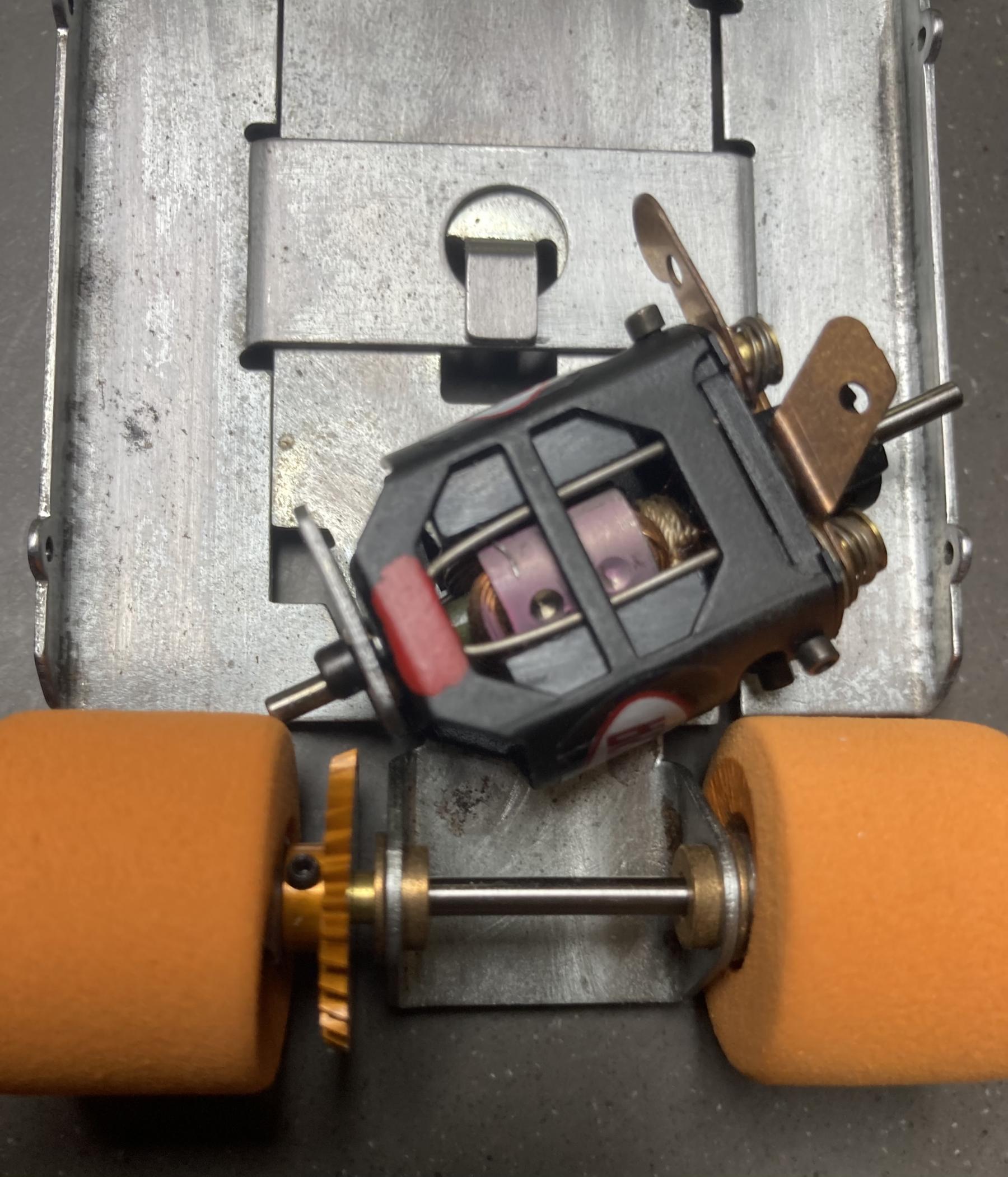

Kindly forgive me with this inquiry as I am attempting to get back into this hobby after decades of not participating, so I am kinda a duck outta water on this would-be build. I am quite puzzled as to why my Mura motor appears to not be an ideal selection with this (vintage) 1/32 Parma chassis and the related gearing setup I show.
As you can see, once I position a pinion gear on the motor shaft, there’s no way that spur gear will properly engage.
Also, I obviously have to select a less wide set of rear wheels to avoid contact of that motor shaft. Rats! I love these old orange sponges.
Anyway guys, please help me out with this setup and enlighten me on the bast path forward.
One last question – the allen fastener on this particular (all-aluminum) spur has an odd, rather tiny head, and my regular allen drive I use on the other gears and wheels isn’t small enough to use on this application. Can you let me know what size of driver I require?

Pretty sure that motor is way too powerful for that chassis. Also that spur gear is typically not used on this type of chassis. Usually they are plastic 48 pitch gears. Where are you planning to run this car? :)

That is simply a motor I grabbed to consider would-be fitment. I probably need one of my old Parma 16D motors in its place.
The other spur gear (plastic variety) I have is much smaller in diameter and seems like it most certainly won’t interface with a motor pinion on this particular setup.
Again, it is apparent I need some guidance here, and further suggestions are appreciated!

Sorry not familiar with that chassis. Typically you would use with a 16D an 8 or 9 tooth pinion with a 28 or 29 tooth plastic spur gear. What track are you running this on?

I'm no womp expert either.
But I can tell you, trying to shoehorn a (powerful) 1/24 motor, gears, and wheels into a 1/32 chassis is going to be a real headache. Yeah, I know the manufacturers may have sold cars like that and made 16D motors fit.
To make that work you'd have to have the exact same parts they used.
In the end, you'll end up with an over-powered, ill-handling 1/32 car with parts that don't complement each other.
If you really want to use those parts, I'd recommend finding an old photo of a Parma RTR car that actually used a 16D motor.
Look at what gears and wheels they used. Maybe it would have been a 501 Parma Deathstar with narrowed tires.
Maybe the tires extended beyond the wheel wells.
You best option, IMO, is find a smaller modern FK style motor and gears that fit.
JK also sells wheels (called reverse hubs) where the left side hub allows the gear hub to recess up inside it.
That way the left wheel won't stick way too far out.
With a smaller, tamer motor the car will be much more pleasurable to drive. And you'll be able to use different gears to fine-tune the ratio.
As far as the screw on the gear, I can't tell what it is. If the thread is 4-40, just get the screw out and use a standard grub screw that uses a .050" wheel wrench.

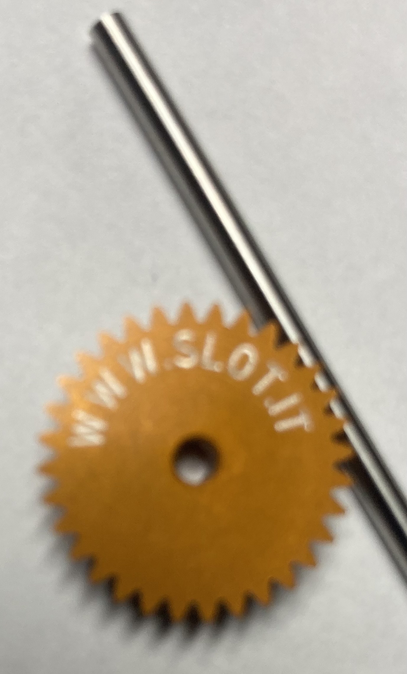

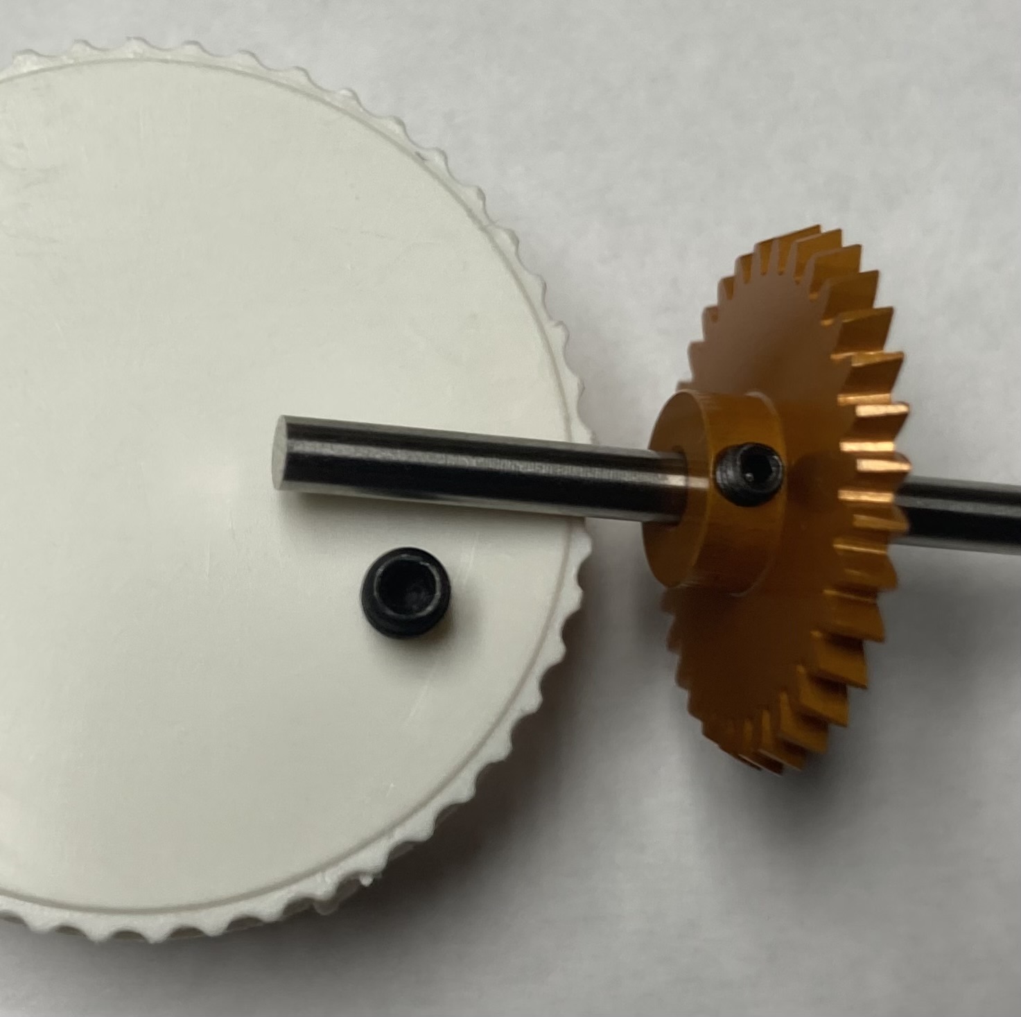

Here’s an image of that odd spur gear showing the allen heads being sized differently. I attempted to swap this smaller allen on the spur with the more typical size available, but the whole set screw itself is smaller. Not simply the drive access hole.

Jim, that's a Slot.it gear from Italy. I notice in the above photos it's a beveled gear rather than straight-cut teeth. As I previous stated, it's probably not 48P.

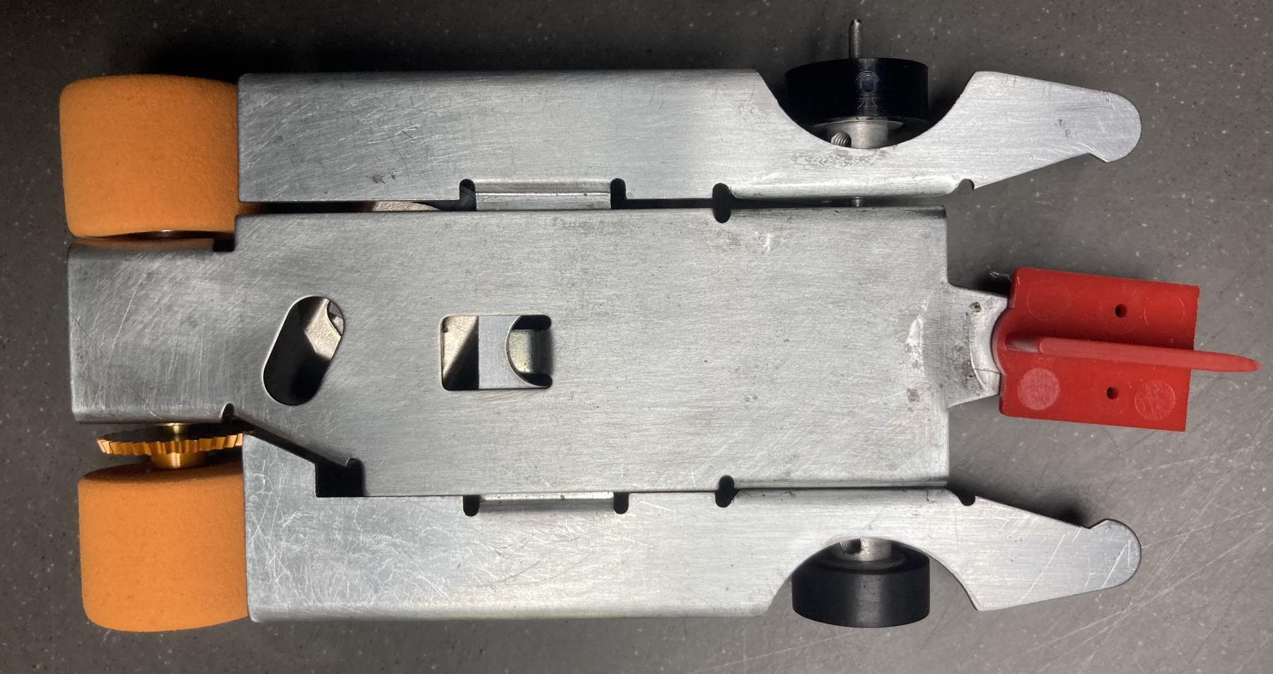

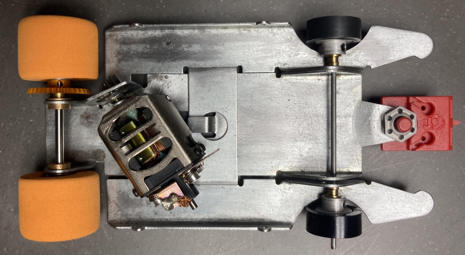

Can you sometime post a photo of your complete chassis? I've seen the Parma brass Intl 32s but don't recall ever seeing an aluminum anglewinder chassis like yours.

Bill, this is actually a stamped steel chassis (I do wish it was aluminum, as I prefer that particular metal in many applications, where possible). I really loved its overall design, and found this chassis quite accidentally on this forum a couple of years ago while checking-out 1/32 stamped chassis configurations. One of our members kindly let me procure one of his nice examples.
Please note I cut (with a Dremel tool) the oval cutouts where the front wheels are situated, to provide a bit more clearance for slight wider wheels. I also wanted to give the chassis a bit more visual interest by introducing these handy curves, to better play esthetically with the front wheel protector extensions, and contrast all the other straight lines of the chassis.
That is just the old, professional designer in me, I guess. I can’t leave well enough alone on anything, it seems! Ha!

Thanks for the photos Jim. In the early photos, the steel looked like aluminum to me, sorry for the mistake. Your chassis appears to be an early predecessor to the Parma 1/32 brass Int. 32 anglewinder. The center sections are very similar, the pans tips in front are different. These chassis would have been made to fit Parma's 16D motors. These chassis are made for 1/32 scale racing, rather than womps, which are neither 1/32 or 1/24 scale. To fit a 16D motor, you may have to modify the chassis mounting bracket &/or grind an axle clearance slot in the back of the motor can. These chassis were designed for smaller rear tires. Your orange ones will probably provide 3/32" or more chassis clearance. I believe your chassis is about 2 1/2" wide. This means the myriad of womps bodies will all be too wide. Their use will require making some sort of pan wideners & attaching them to the pans. There are some 1/32 scale bodies that are narrower & will fit r ight on your chassis. Locally, we once ran FK motors (Falcons) in the Int. 32 chassis. Those cars had plenty of speed &handled well.
The motor in your chassis photos is an RJR C-can with some sort of arm. Is the arm tagged?  Your modification to fit the wider fronts looks nice. If you ever want to build a pure womp, Mid America sells new womp chassis, but you can often find good used ones on eBay & Facebook Marketplace.

Why didn't you just say it was a Slot.it?  :dash2:  :laugh2:
The grub screw size is 0.9 mm.
The gears have their own special pitch and you have to use a Slot.it pinion with Slot.it spurs.
