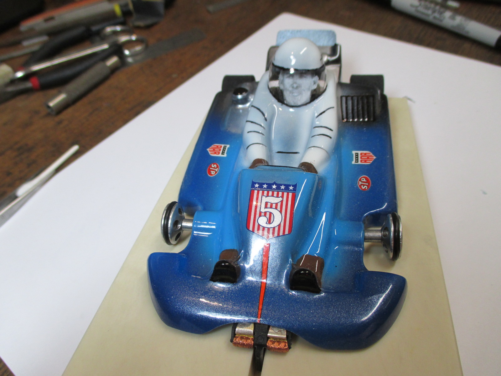

Ready for the body.
Passes the drivetrain test with flying colors.

One final step - a dot of glue on the end of the axle:
Boop, second insert goes home and in perfect position. I don't even need to check it.
Go-Kart is done.
