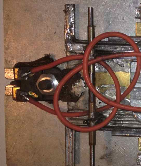

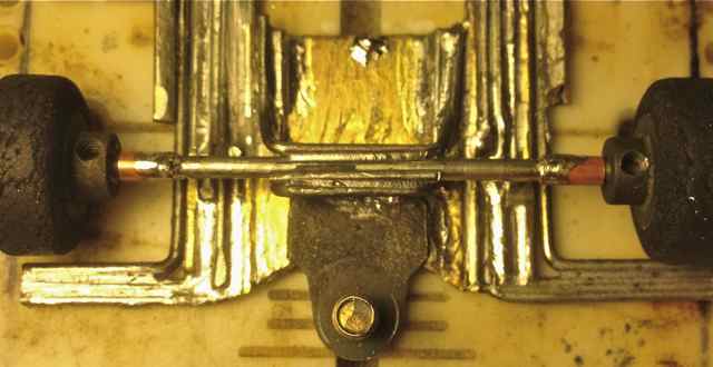

Slight rework on a 2009 chassis I updated earlier this year. The guide length was over .75 IRRA max & slightly tweaked, so now it is a legal .65 & straight.
The old
New & Improved
Think this will be easily replaceable, particularly if I prep a new spare axle as Pablo recommends.
BTW these are iPhone 4s pics.

#1567 Preston M
Preston M
  • 494 posts
  • Joined: 04-January 11
  • Location:NY
Posted 18 May 2013 - 02:32 PM
I would go over those joints with more flux and let the solder flow a bit more. It will get rid of the clumpiness. Otherwise nice job!

#1568 Tex
  • 9,270 posts
Posted 18 May 2013 - 06:37 PM
Ditto. Lotsa flux, lotsa heat.

#1569 macman
macman
  • 1,108 posts
  • Joined: 31-July 06
  • Location:Charlotte, NC
Posted 19 May 2013 - 11:55 AM
You do realize that these joints have had all the excess solder accumulated during building ground off...

#1570 Preston M
Preston M
  • 494 posts
  • Location:NY
Posted 19 May 2013 - 01:20 PM
That is one way of doing it. Another is to use more flux, less solder. Allow the solder to flow, it will prevent the need to grind off excess solder, because there won't be any.

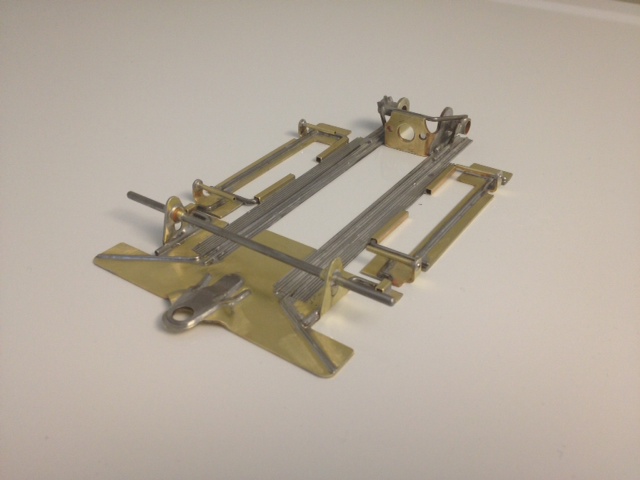

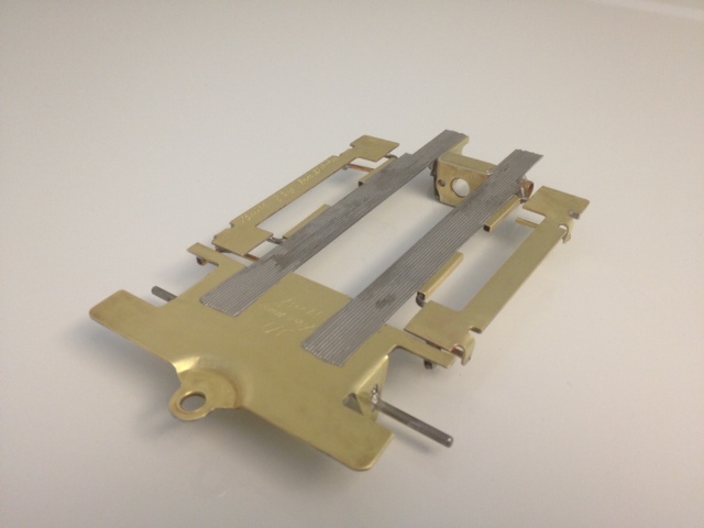

#1571 ejgehrken
ejgehrken
  • 345 posts
  • Joined: 07-May 12
  • Location:Southington, CT
Posted 21 May 2013 - 04:47 PM
3D Racing Chassis #017
30-Rail Can-Am Chassis
30 rails of 0.032" wire
4" wheelbase, 0.940" guide lead
RGEO Samurai 3 Kit w/ 3/4" RGEO Bracket

#1573 MSwiss
  • 26,238 posts
Posted 21 May 2013 - 07:03 PM
Eric,
Great job, as always.
I wonder if some ambitious chassis builder will ever bother to build, an of course illegal, test mule, with 1 pc. flat spring steel rails,
just to see if it these multi-piano wire chassis, mimic a true spring steel railed car.
  • Duffy and ejgehrken like this

  • 3,791 posts
  • Joined: 25-January 09
Posted 21 May 2013 - 07:43 PM
Yah, but - still not the same, the disparate metals (steel/solder) wouldn't mimic the sawn plate. Too bad. Lots more fun to do this sort of thing and believe we've got a good substitute!

#1575 MSwiss
  • 26,238 posts
Posted 21 May 2013 - 07:54 PM
It's of course a totally different temper.
I don't expect it to mimic it, or think it should.
I just wonder if it might, or might be superior.
But I don't wonder enough to try it myself.
That's what young men like Eric are for. :)
