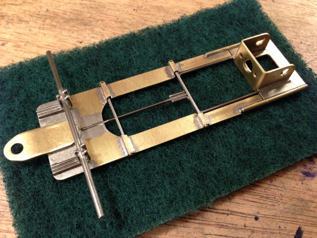

Hello everyone,,Iv been building some F1 chassis.2 are for Foamy,and the 3rd is for a customer.All 3 chassis are of the same basic design but have slightly different dimensions,in my never ending search for that "Perfect Car".........Hand cut from .040 brass,with a piano torsion bar up the center,,also these cars are very light,as DCR #19,the chassis in this photo weighs only 43g......thats going to build a 88-90g car,,,but adding weight if needed is easy.
Take Care all..................DC

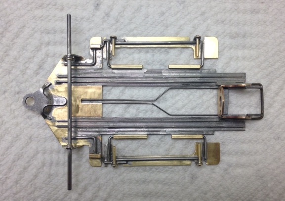

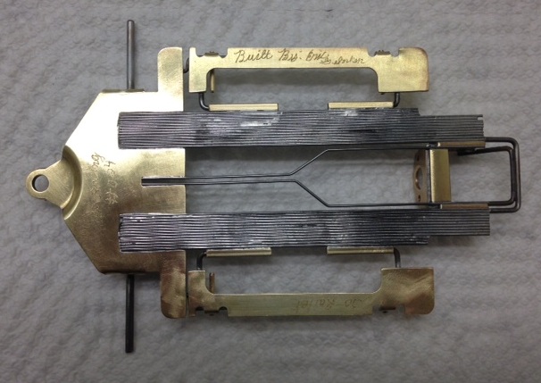

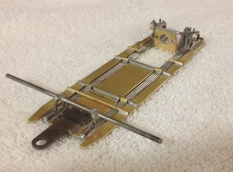

Here are two builds I did for Rich Goucher, a local at Rapid Raceway in Plainville, CT who's going to start racing retro.
First Build:
3D Racing Chassis #022
Can-Am Chassis
8 rails of 0.047" wire
4" wheelbase, 0.940" guide lead
1" Chicagoland Versa Bracket
Chicagoland Guide Tongue

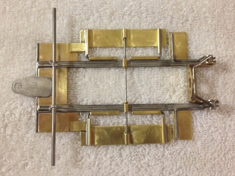

Second Build:
3D Racing Chassis #023
Formula 1 Chassis
4.125" wheelbase, 0.940" guide lead
FSF F1/A1 Kit
  • Brian and DCR like this

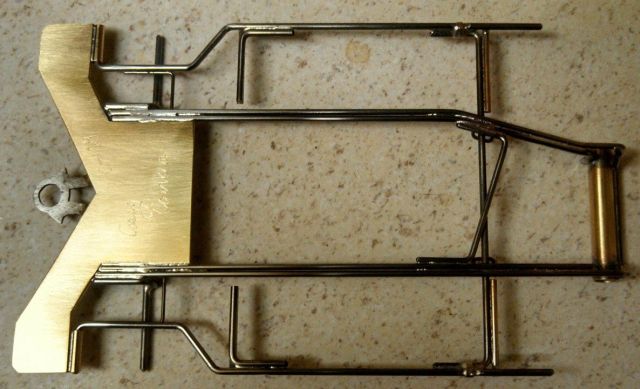

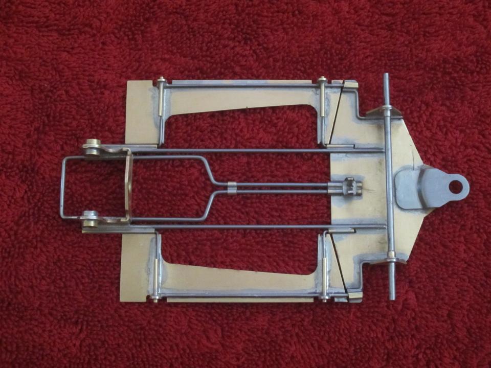

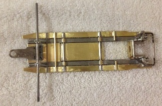

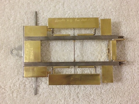

3D Racing Chassis #024
Can-Am/Coupe Chassis
30 rails of 0.032" wire
Tuning Fork w/ 0.032" wire
0.75" Chicagoland Versa Bracket
RGEO Samurai 3- GVP Version
  • MSwiss, John Miller and 7D7 Hobbies like this

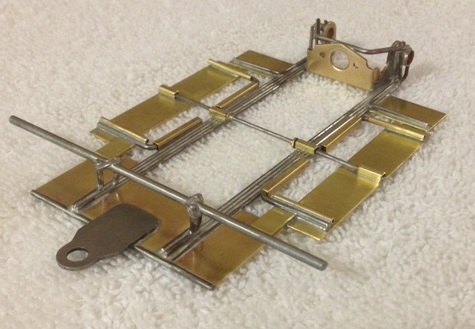

Another Saturday going by with me spending the majority of it at the bench building the next RetroPro chassis.
It was a fun challenge figuring out the pans, bite bar assembly and bracing.  See below for the new sled.

#1814 ejgehrken
ejgehrken
  • 345 posts
  • Joined: 07-May 12
  • Location:Southington, CT
Posted 22 September 2013 - 11:36 AM
Thanks, Dom! It weighs 56 grams.

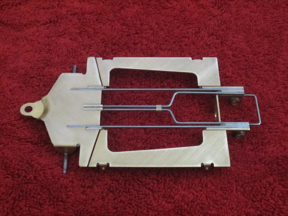

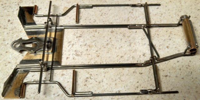

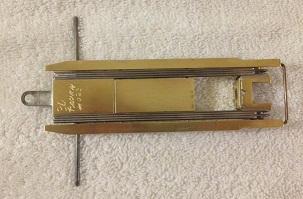

I've been wanting to try a tuning fork chassis for awhile now and finally got around to building one. It's inspired by some Greg VanPeenen  designs that I have seen. Came in at 48 grams as pictured so it should be right around 100 grams completed.
Thanks for looking,
Raisin

Posted 23 September 2013 - 03:13 PM
Nice-looking chassis, Raisin.
However, I recommend that you brace the rear axle tubes and the bracket.

#1820 John Miller
John Miller
    This space for rent
  • 1,150 posts
  • Joined: 12-November 07
  • Location:Hartford, MI
Posted 23 September 2013 - 05:15 PM
Nice build...
Is this tubing soldered or does it slide to adjust flex?

#1821 MSwiss
  • 26,238 posts
Posted 23 September 2013 - 05:19 PM
Knowing Raisin, I bet that baby is an adjuster. LOL.
#1822 Craig
Craig
  • 1,691 posts
  • Joined: 13-March 08
  • Location:S Lake Tahoe, CA
Posted 23 September 2013 - 05:21 PM
John,
I would guess no, looks like it is crimped which would allow you to move it aft or fore to give more or less flex in the tuning fork. Just a guess though...

#1824 raisin27
raisin27
  • 508 posts
  • Joined: 11-March 13
  • Location:Garden City, MI
Posted 23 September 2013 - 06:53 PM
Thanks, guys.
Yes, the brass piece your talking about does slide back and forth. I don't know if adjusting it will make a noticeable difference or not but thought it might be worth a try.
Raisin

#1825 Craig
Craig
  • 1,691 posts
Posted 23 September 2013 - 07:32 PM
Michael,
I built a GVP clone tuning fork car and yes, the adjuster I installed made a difference.
Craig Correia
