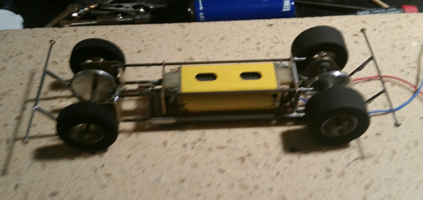

#30 Joe Mig
Joe Mig
  • 3,077 posts
  • Joined: 25-February 07
  • Location:Queens, NY, USA
Posted 25 June 2015 - 08:59 PM
Its comming along bit by bit. I recived my order from PCH nice and fast.
In and out with long John to get the drive shaft done and next time the motor goes in it stays for a while. I cut the tires down to the hight of the ones from the model but im not going to norrow them untill a shakedown.
I did the front body mount and the rear is next.
  • hiline2 and C. J. Bupgoo like this
#31 havlicek
havlicek
    OCD Rewinder
  • 11,198 posts
  • Joined: 20-August 07
  • Location:NY
Posted 26 June 2015 - 06:59 AM
Really nice Joe!  Now the ultimate question: will it burn rubber...or just burn?  :)  Build-on!

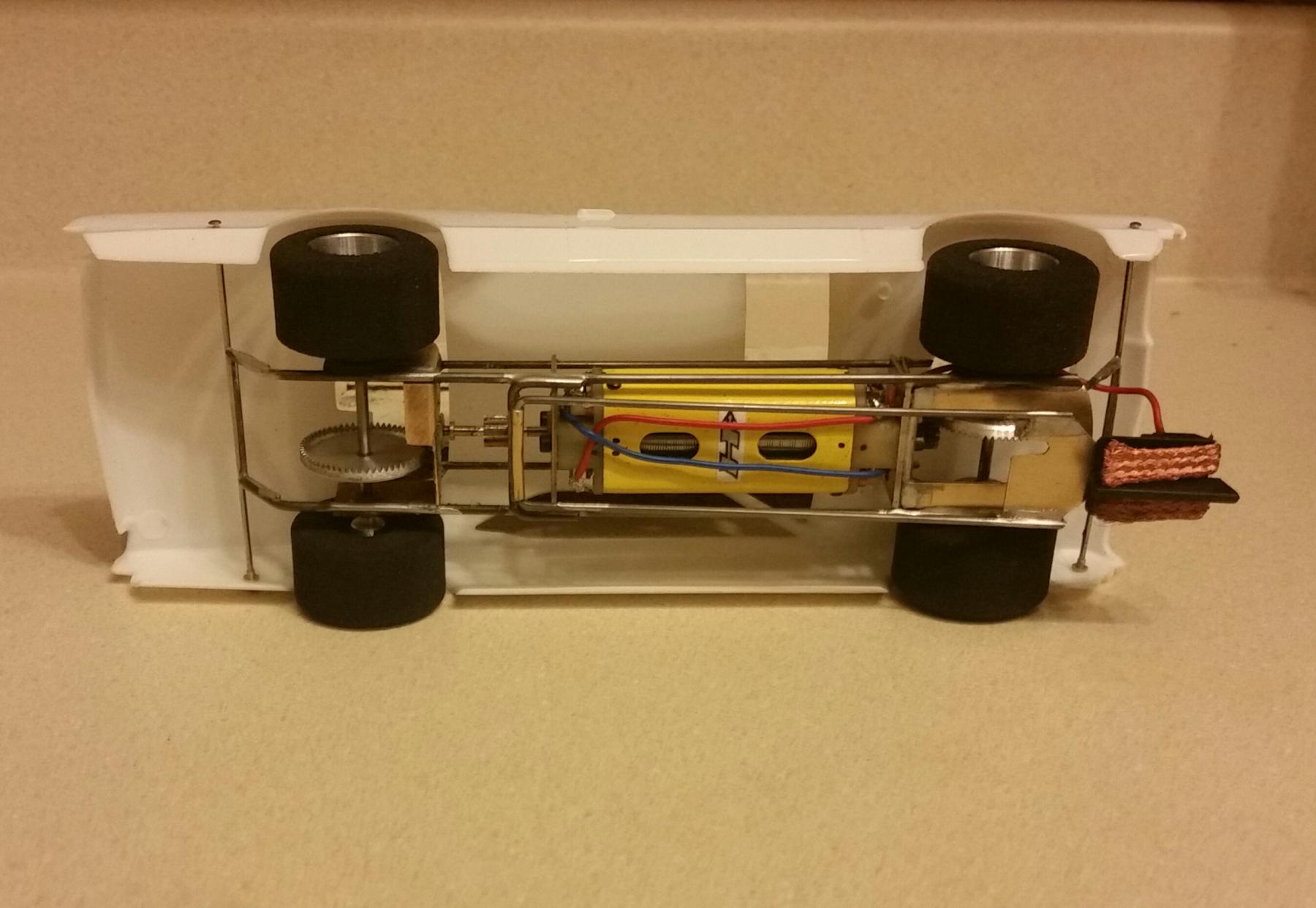

#37 Joe Mig
Joe Mig
  • 3,077 posts
Posted 26 June 2015 - 06:13 PM
I sure hope it goes straighter then that Mike.
So both body mounts complete and this is the stance. A bit high but the olny choice I have wirh the tall tires all around and I wanted the rear to sit the same as the front and not lower.
all in all not bad.
20150626_182800_resized.jpg 20150626_182239_resized.jpg 20150626_182342_resized.jpg
  • havlicek and C. J. Bupgoo like this
#38 Joe Mig
Joe Mig
  • 3,077 posts
Posted 26 June 2015 - 06:17 PM
Time for the last chassis bath.
next step is assembly of the motor and chassis running gear.
  • havlicek likes this
