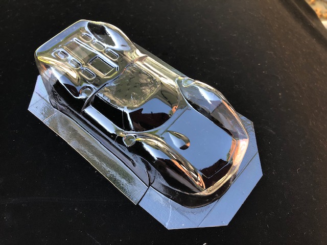

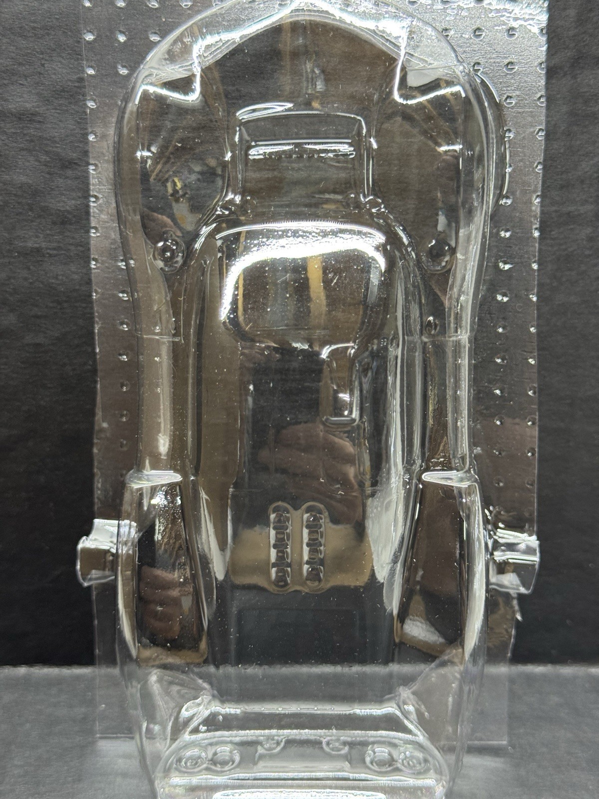

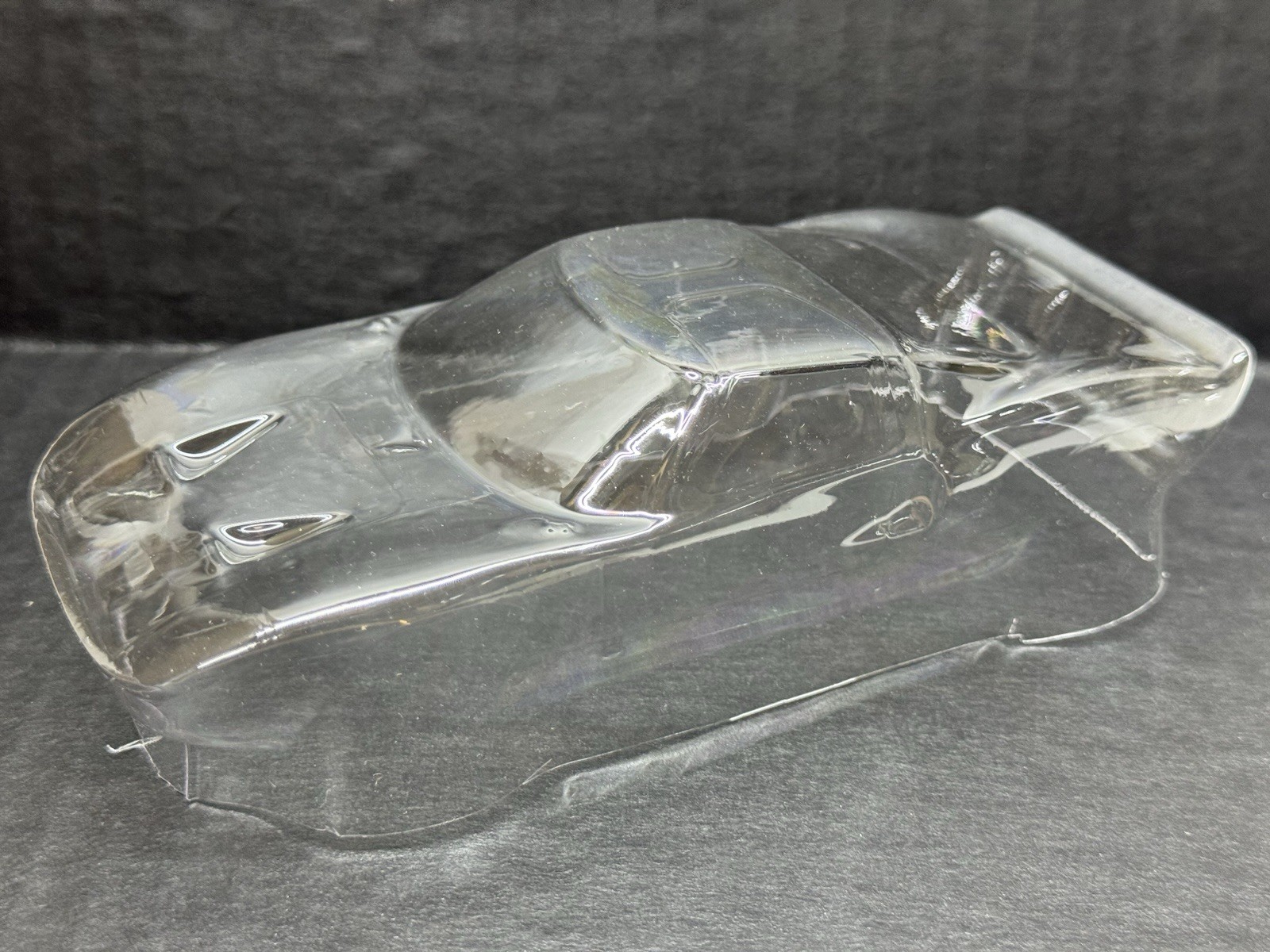

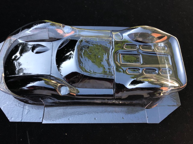

Carefull placement of vent holes. And carefull cleaning of mold surfaces.
#78 Martin
  • 4,659 posts
Posted 26 August 2025 - 11:23 AM

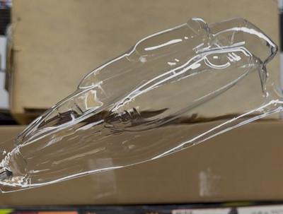

Man, I grabbed some images of repo bodies on ebay. Vent holes for sure in the correct place would help, but total rejects IMO.
Check out these, Soft exit vents on the Ford GT
Texture front windshield on the 2D and a blob of a Shelby turbine Indy car.
Hope yours are better than these Scott?
Theres more to it than that.
Sharp clear details
Lotus 40, deep undercuts. Bodies are clear
  • dc-65x, Fergy, olescratch and 3 others like this

#82 Dave Crevie
  • 5,129 posts
Posted 26 August 2025 - 07:31 PM
You are correct. A lot of issues present themselves depending on the complexity of the body. Your pre-war Grand Prix body is far more difficult to pull than, say, a Lotus 40.
Sharp clear details
Those are clean runs. Very nice.
#85 Martin
  • 4,659 posts
Posted 26 August 2025 - 11:40 PM
Beautiful Gene, you have mastered your craft. Really nice examples of how detailed and crystal clear a reproduction body can be.

Gene what are you doing for a clean room to remove dust and particulates?

  • 2,991 posts
Posted 27 August 2025 - 04:40 PM
Many, many tiny holes for the vacuum to suck down the plastic. It's in a thread here somewhere.
  • Fergy likes this

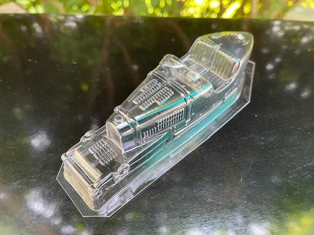

The dynamic is sweet, you will like it.  I pulled the bodies  in .015 so they should be great as runners and not to heavy.

Looks great!  Now I need to get some interiors for them and a 906 I'm finishing.
.015 is fine. I don't mind the .020 bodies because they are harder for me to screw up when I'm trimming..... :laugh2:
The Ford will go on one of my Dynamic Sidewinders which I used to set the track record on Kit Car Night in 1966!
The Lola will go on a new design printed chassis I'm fooling with!

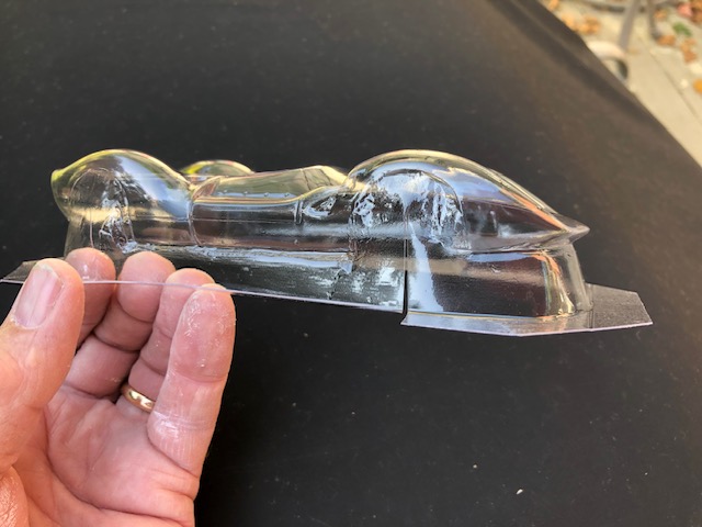

I threw in a couple interiors I ran years ago. I also threw in a test example of the K&B Ford GT MKII interior. Not the best pull it was one of the earlier beta pulls as I was working on the mold but maybe you can make something with it.
Scott
My vacuum room is located in a finished basement and has a door. Has heat and AC. I like the humidity aground 53 %.
I cut 4 x 8-foot sheet plastic for the bodies there also. This room has all my molds about a 120. Each mold is kept in a plastic bag in a drawer until needed.
The room where I make molds is about 50 feet away from the vacuum room and it can get messy in there, so clean up as you go.
Now making bodies, take a microfiber cloth and spray with glass cleaner and wipe the platen and vacuum table down, also wipe down each piece of plastic before you remove the protective film, if you don't any dust on the film will transfer to the plastic piece. Wipe your mold down with a tack cloth. Lastly where a clean T-shirt as lint from your clothes can become flyable and will transfer to your plastic.
Sounds crazy but I don't like an ugly body with dust and lint. I try my best to make a as good or better body than an original; this also includes making a high-quality mold.
I like doing this so the hobbyists can enjoy recreating there dream cars, but it can be time consuming.

  Appreciate the information. Humidity is a buzz kill on bodies. I have always wondered and, should probibly try, to see if a static matt could help cut down on the static electricity the plastic gets with the protective film.

It's really difficult to remove or prevent static electricity with non-conductors. Use an anti-static mat, anti-static solution/spray, and an air ionizer. You might even want to try a human ground strap, so that charges on the body don't influence the plastic. Higher humidity makes the air more conductive, and ionizers are really useful, but the ionized air has to blow directly onto the material to be neutralized. In the electronics industry, we were trying to prevent static generated by non-conductors from zapping our sensitive components, and useful products were created to minimize static charges on plastics.
