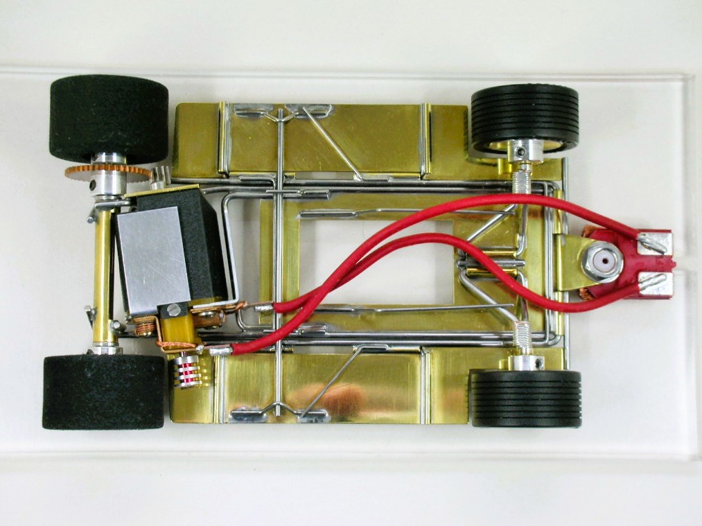

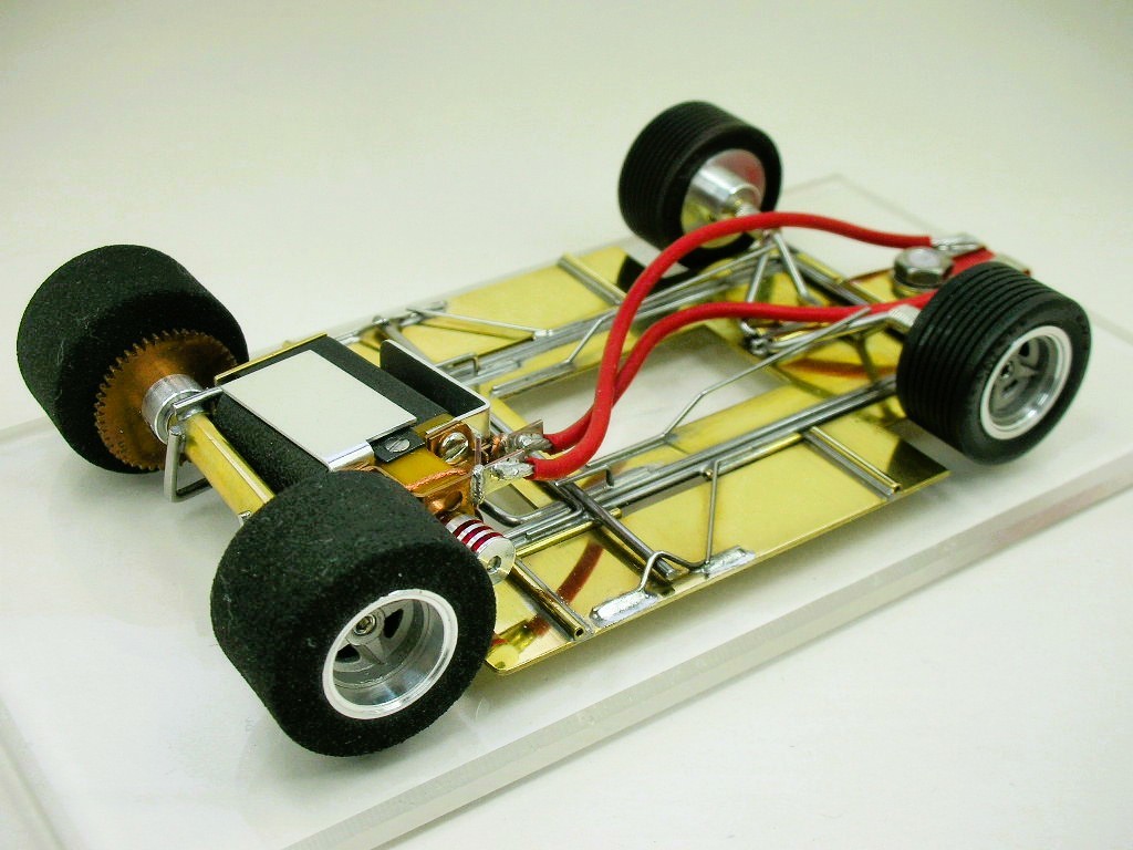

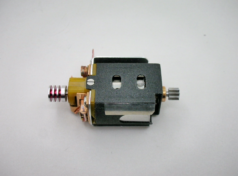

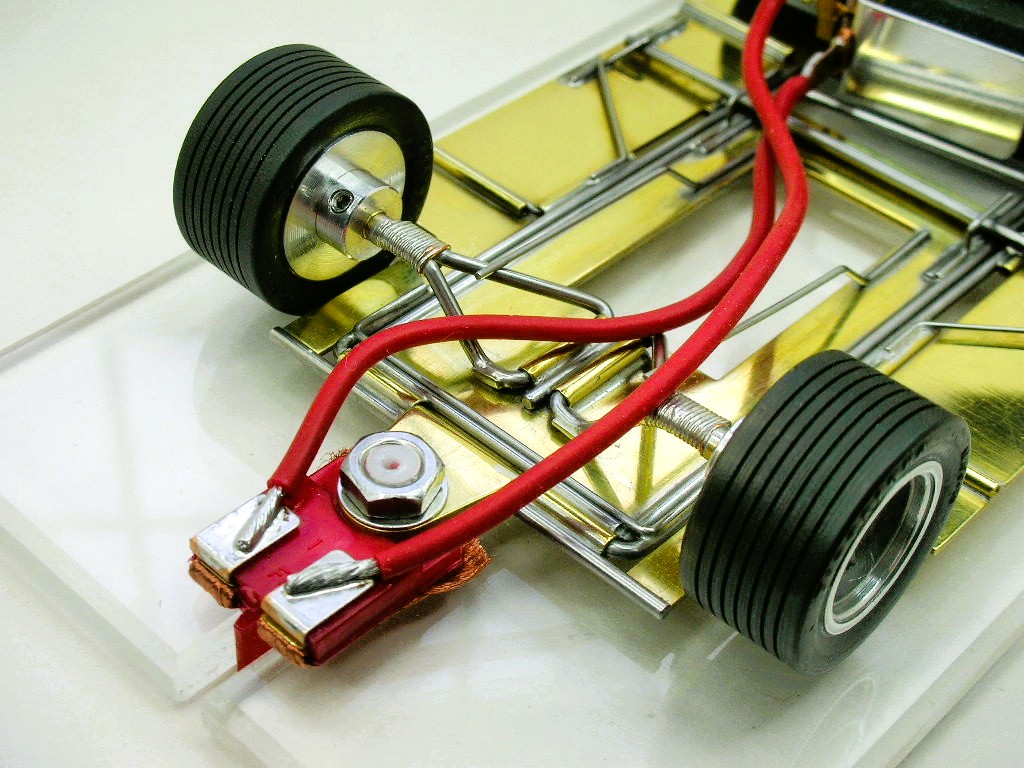

I started fixating on the body and finally realized I hadn't added lead wires and guide to the rolling chassis. Here's the finished roller all ready for the body:
Vintage Champion lead wires and a good old JET flag:

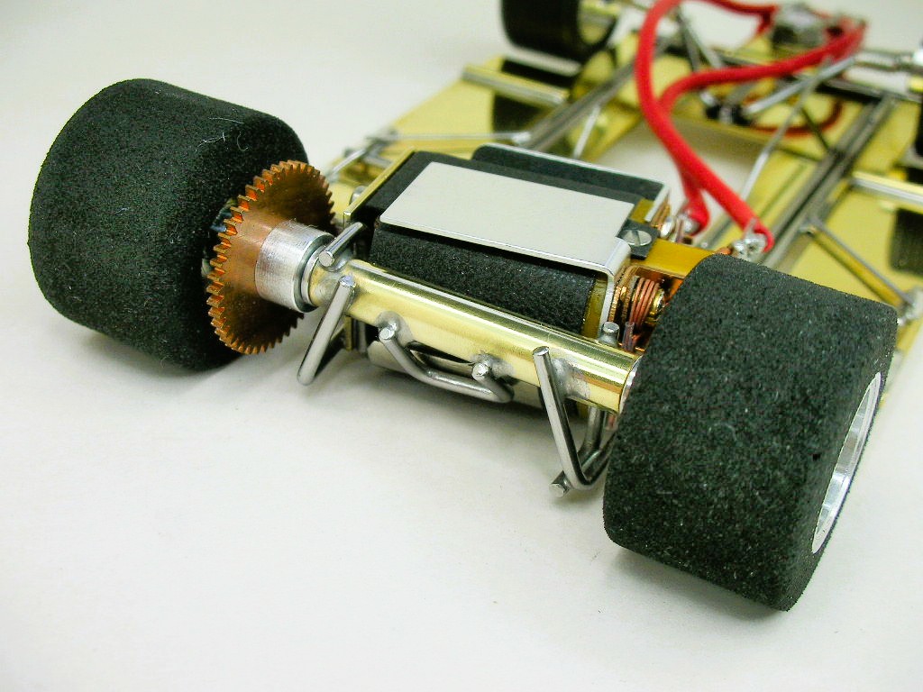

Fass 45T spur and 9T pinion:
Looks like a 7/8 scale Pro car with BIG tires.    :crazy:
The body is also finished and coming up next.........

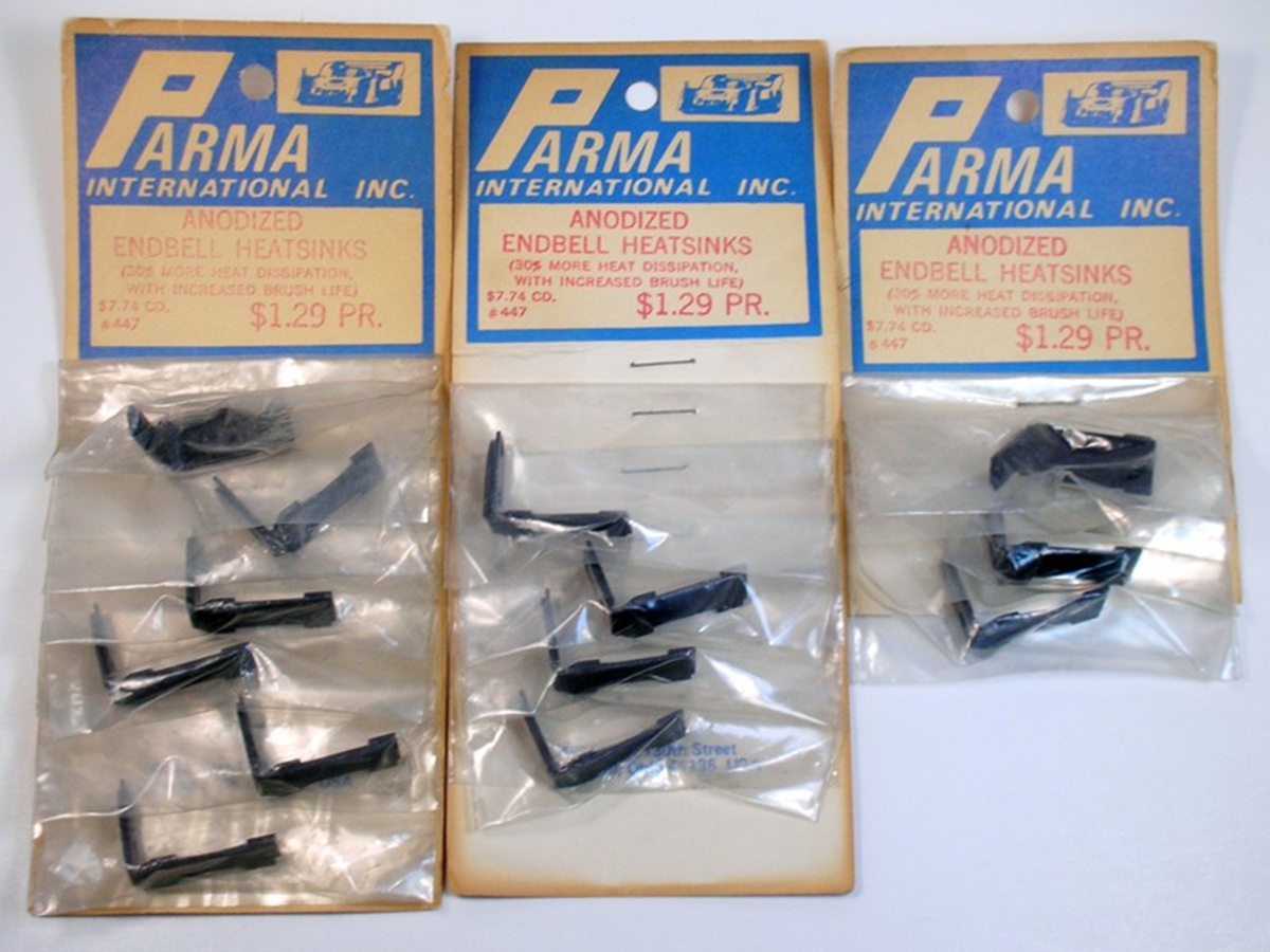

Since Pablo brought up the subject of the awesome Elephant Ear heat sinks, and hoping not to be Captain Obvious....
Black surfaces are way better at both absorbing and emitting thermal radiation than plain metal surfaces.  For example, in sunlight, a black object will heat up faster and to a higher temperature than the same object in plain metal because it absorbs more light energy. Conversely, in a cool environment, it will also radiate that heat away more effectively than plain metal, especially when the plain metal is shiny.
Of course in this case the intent may be to look neat rather than to obtain the maximum heat transfer rate, so as always in Rick's amazing builds this has been accomplished in spades.

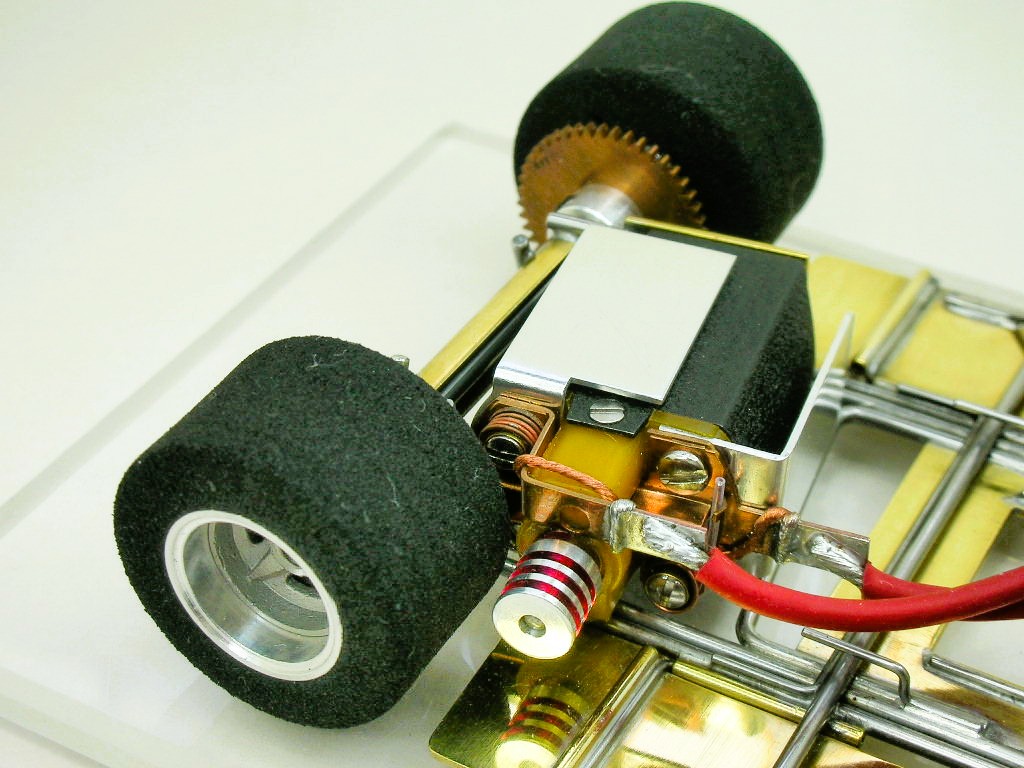

#83 dc-65x
  • 7,204 posts
Posted 28 November 2025 - 01:24 PM
Thanks Mike    :)
Those forward facing heat sinks are pretty cool Pablo. As Bill said these particular ones were from Boyington:
I have some others, Parma for sure.
Parma also made these black versions Jay:
Bill, sometimes I start thinking about the next project and forget what I need to do on my current one.    :o    :wacko2:

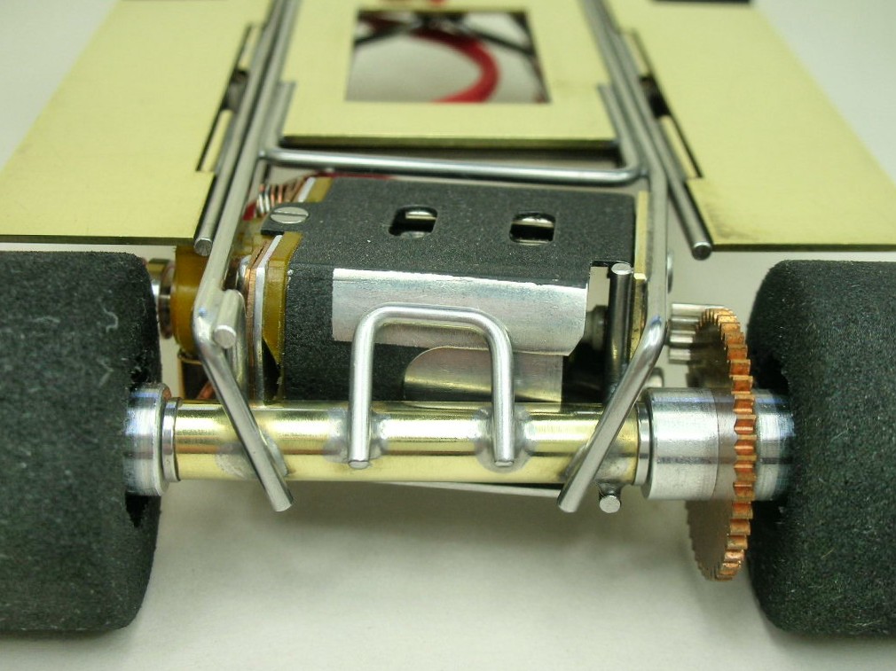

I always like to tin the motor can for a solder on motor mount:
I wait to solder the brace to the rear axle tube until I have the motor locked down tight with the 2 screws and the gear mesh adjusted.
I'll get it installed and post a picture before I put the body on.    :victory:

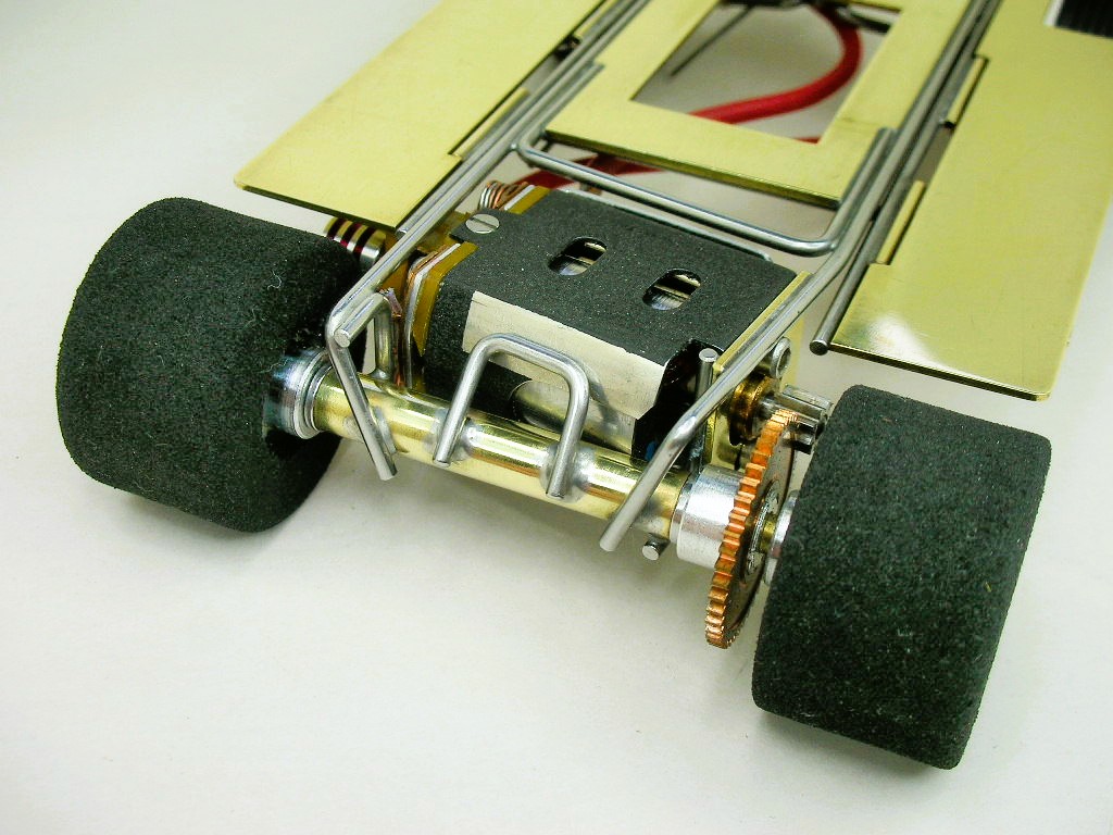

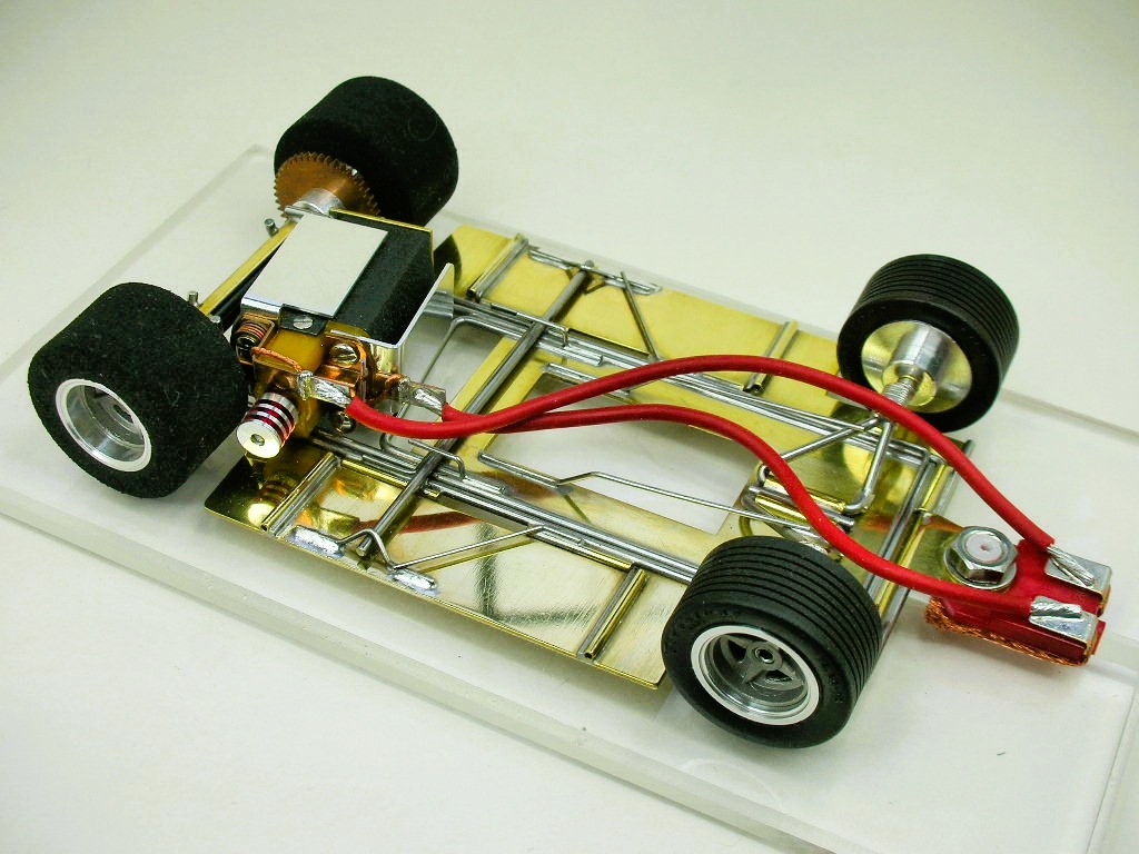

#84 dc-65x
  • 7,204 posts
Posted 29 November 2025 - 01:41 PM
 Now the roller is really finished with the addition of a soldered in motor mount:

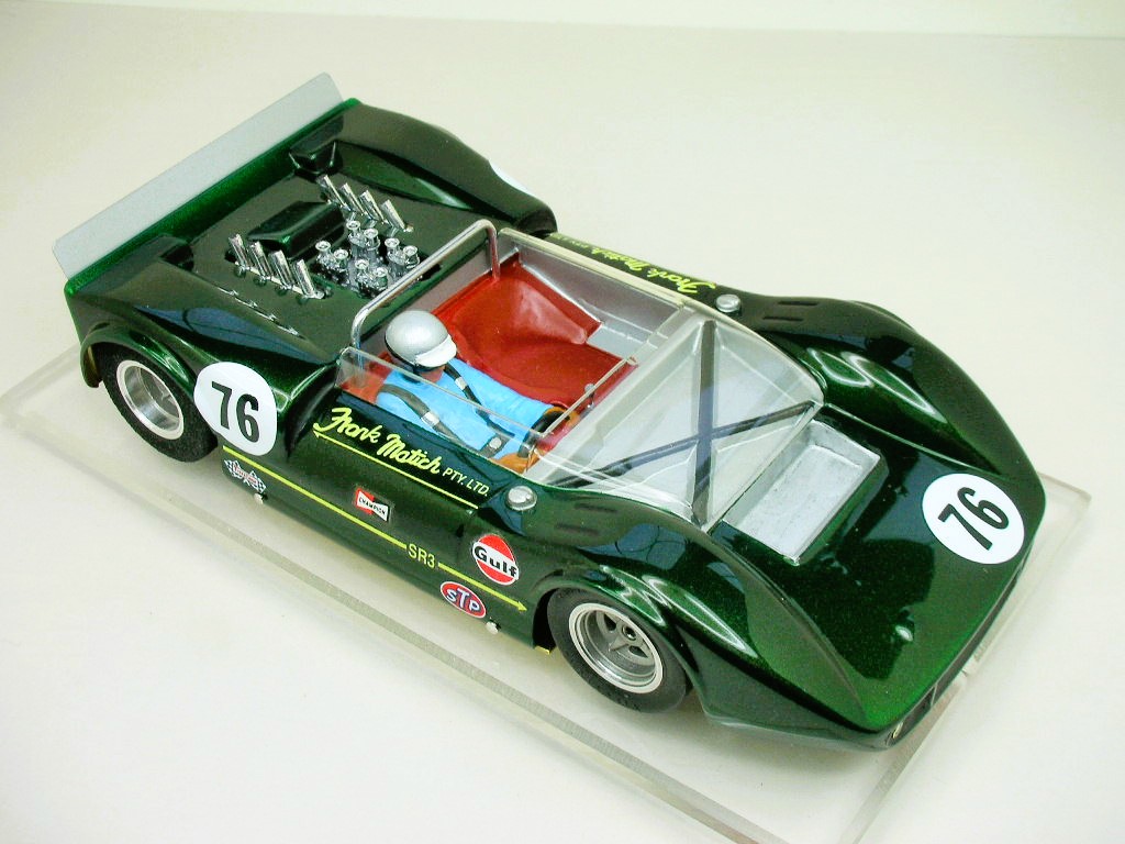

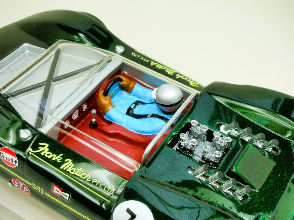

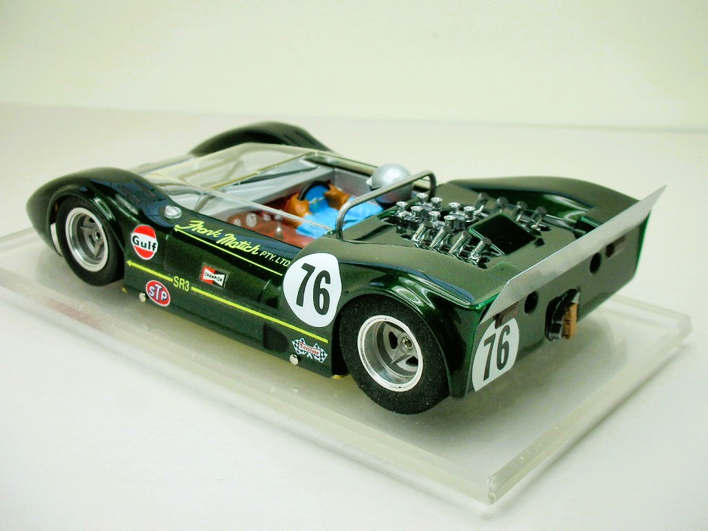

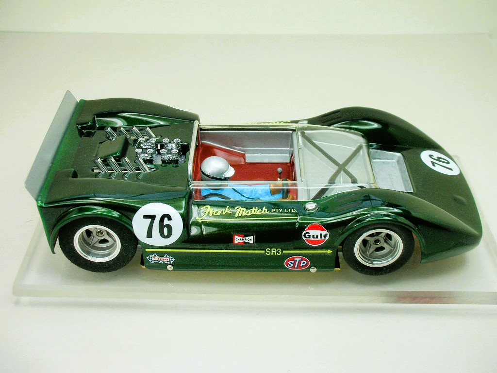

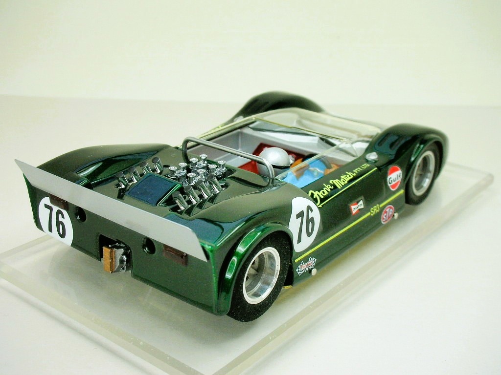

Finally the Matich is altogether in one lump:
My beloved zoomies
The view my little driver hopes to show the competition:
This was a fun project to build. The looks and size of a scale car...........
...........and the mechanicals of a Pro car:
I'll post some comparison photos of the scale and low and wide handling body version next..........

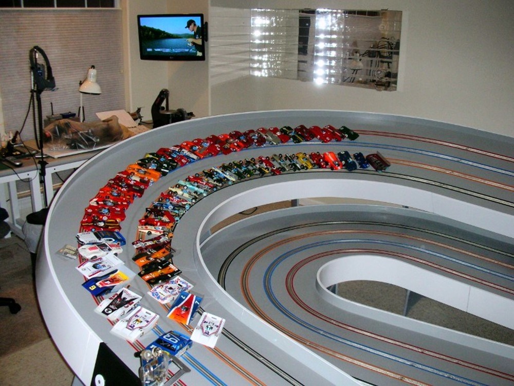

#92 dc-65x
  • 7,204 posts
Posted 02 December 2025 - 01:04 PM
Thanks everyone for your much appreciated support.    :)
Brian, I've built 3 of 6 scale light weight versions of Lancer's Super Competition Can Am cars listed in the top of this Lancer ad:
The scale light weight versions I'm building now are listed in the bottom of the ad. I still have the Chaparral 2G, McLaren M6 and the Ferrari Can Am to build. I'd like to picture those 6 together when they are all done.
In the mean time here are all my cars when I first moved waiting to go into the display cabinets:

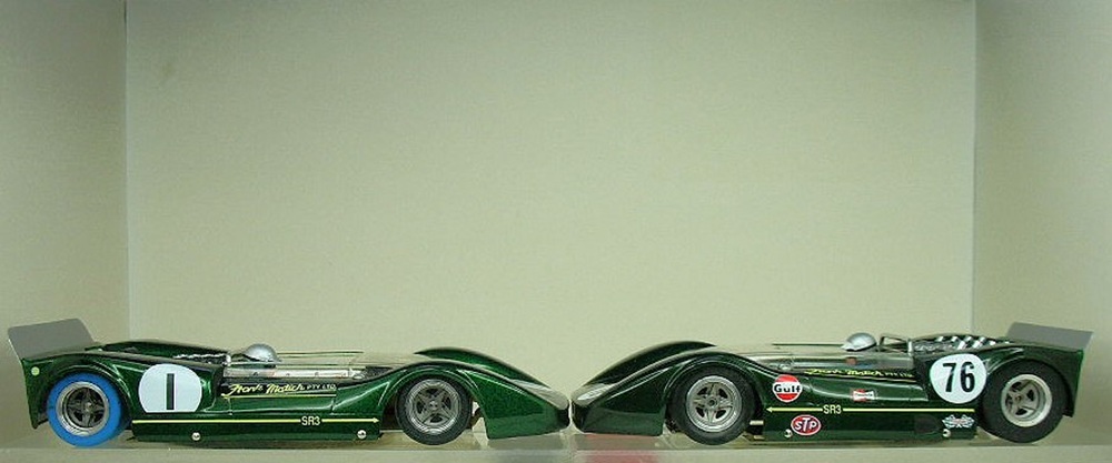

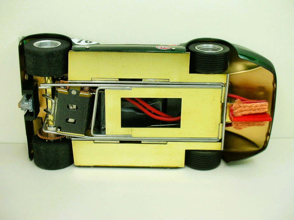

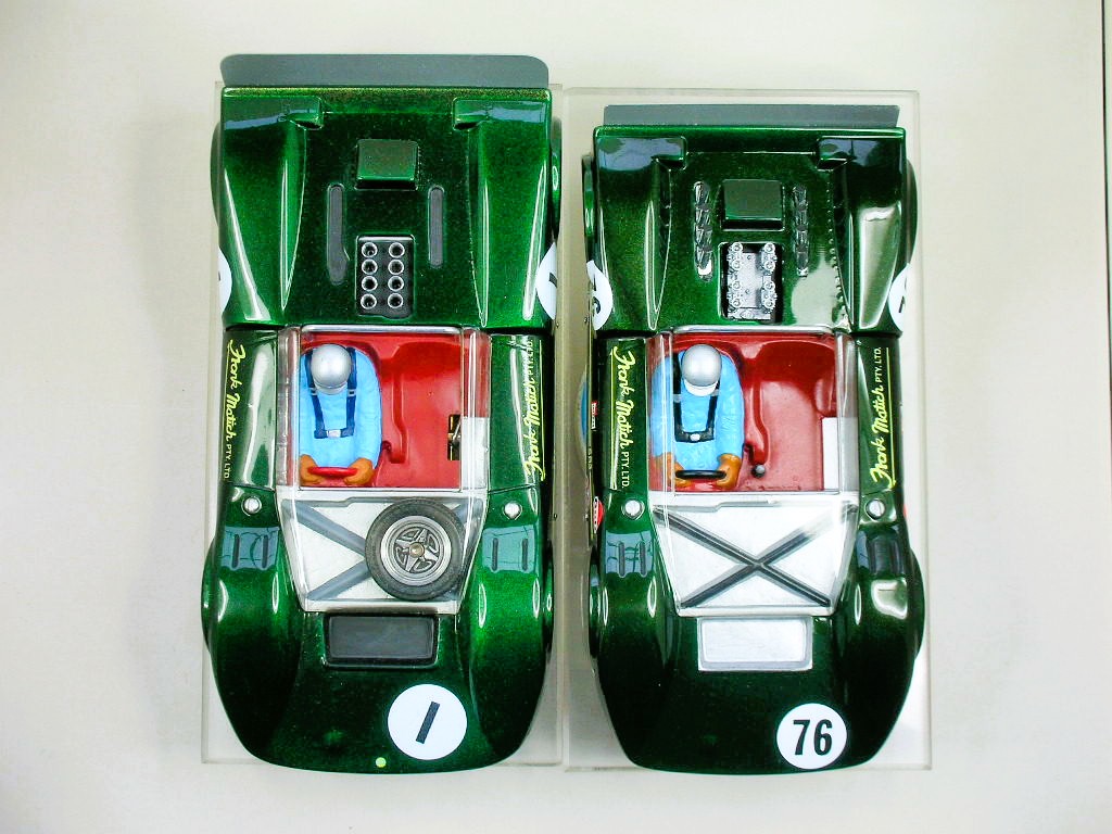

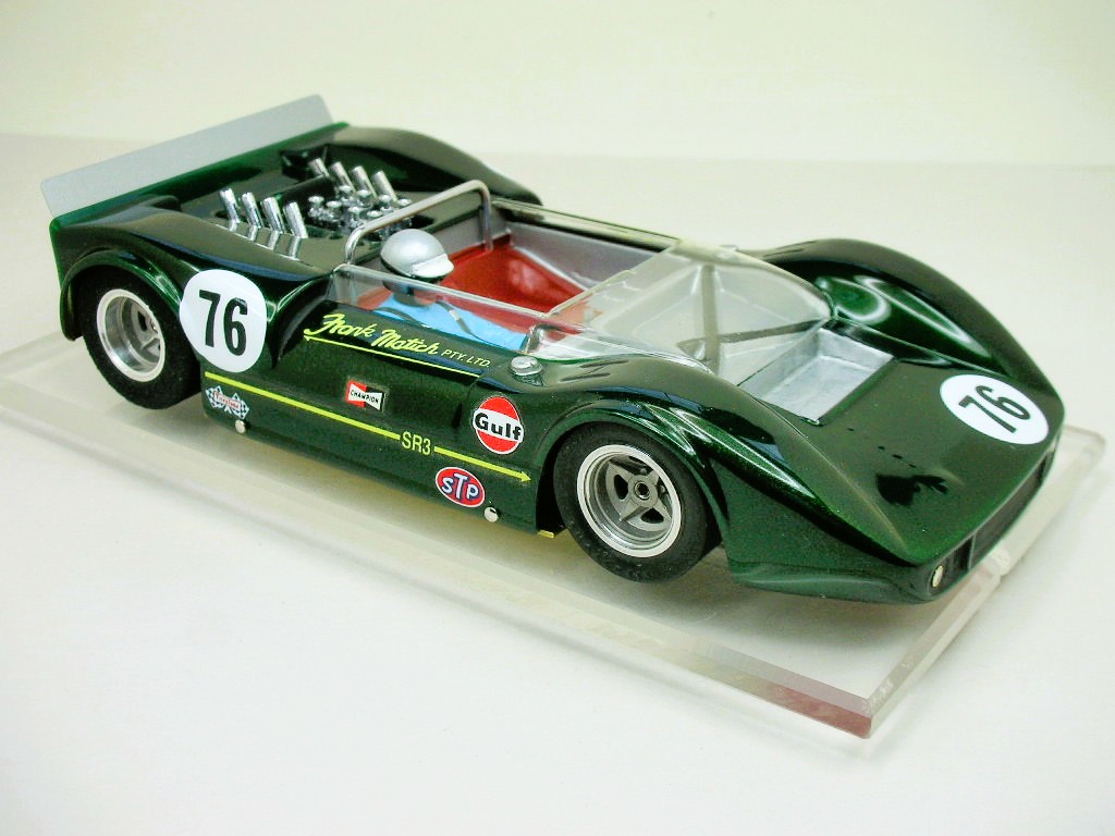

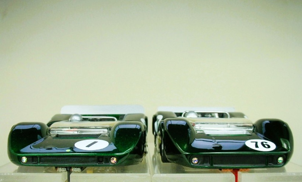

For this current project, here is a comparison between Lancer's Super Competition low and wide handling body version of the Matich with my new scale light weight car on the right:
I'm really liking these scale early Can Am cars.    :dance3:
