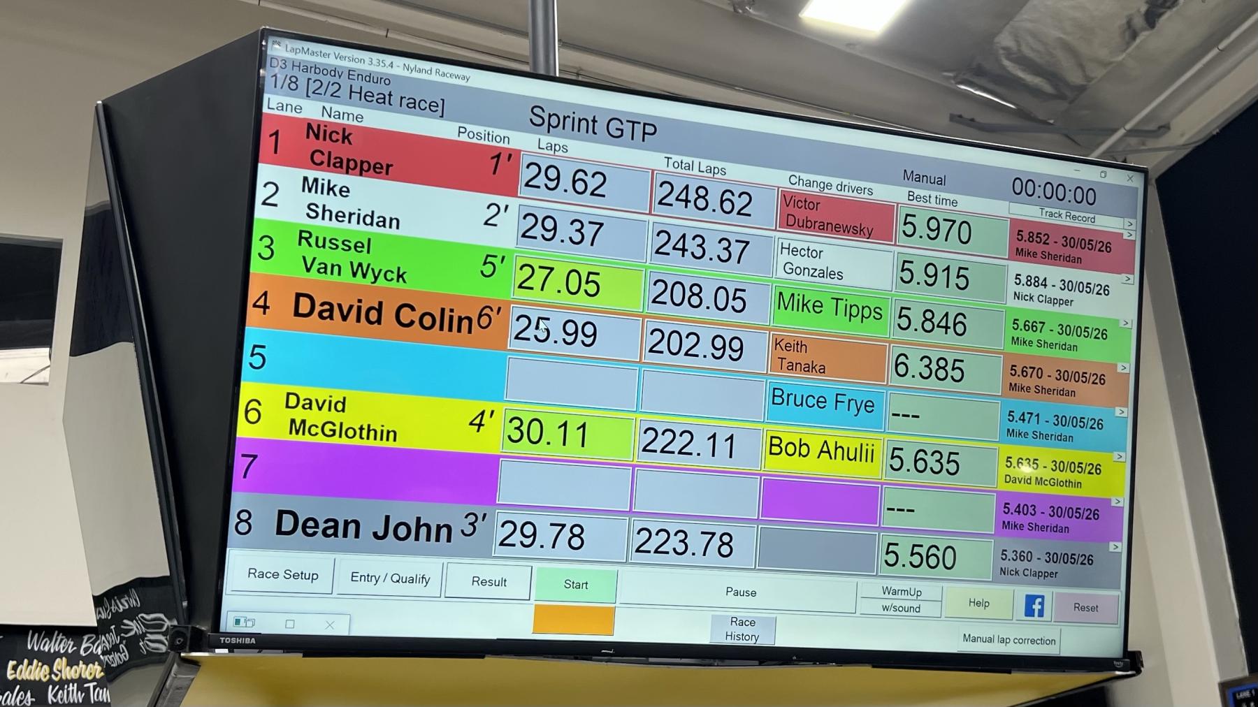

Well I completed my first race, although the body was unfinished, at least I know how it performs out of the gate. Here's the standings...
We were the slow bunch, the fast racers did 45 more laps on average and raced after us.
I borrowed a Third Eye FET controller for the race because my Slot.It SCP2 just isn't really made for these cars and has essentially no brakes.
I have to complete the body, and after riding someones lane during practice it flew off the track and smashed into the wall, breaking the rear section off. I need to properly affix the rear section to the main, the gap-filling CA didn't do it. I'll use acetone to get it back down to the plastic on both parts and use thin fiberglass sheet to make it one. I'll extend the FG to the exhaust and rebuild that part too because it broke off.
There's just no way these bodies will survive a full trigger blast down the straight and into the wall, something has to give!
Before the last heat I found my chassis was broken in the rear below the pinion. I need to investigate it and make adjustments. Pics will come of course!
