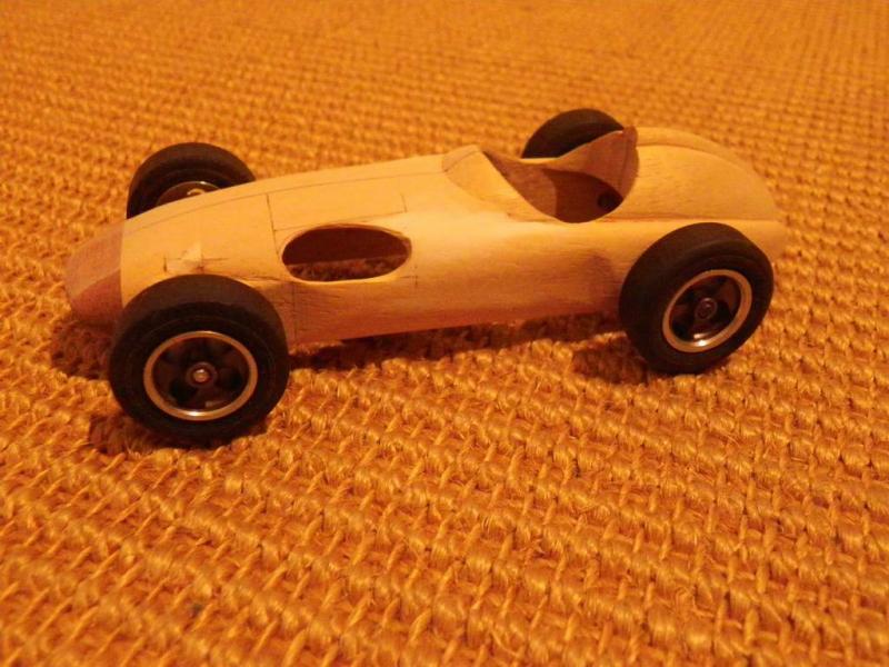

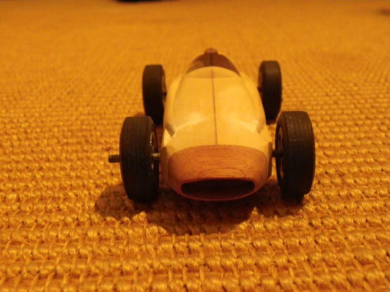

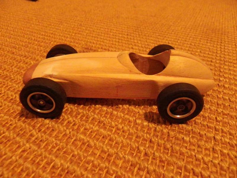

Here are photos of the 1955 BRM my very young friend Nicolas who made the wooden body frame and rims
url=http://folm.xooit.co...ab0fea.jpg.htm]imgp1110-3ab0fea.jpg[/url]
imgp1189-3b3b650.jpg[/quote]
imgp1266-3b8edf5.jpg[/quote]
last night in the first test on the track Ninco our club.
  • slotbaker, miko and Bruce Wayne like this
