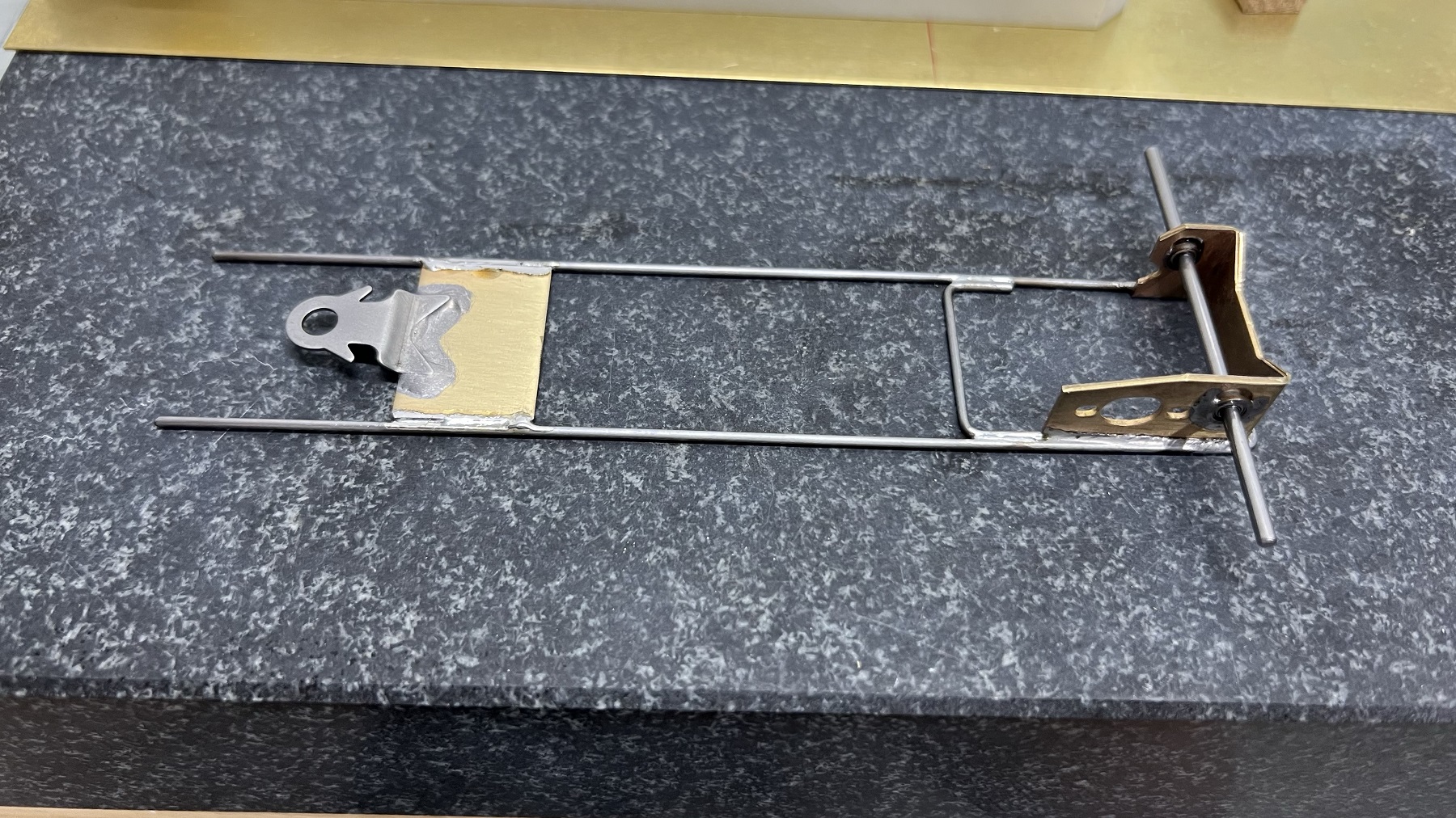

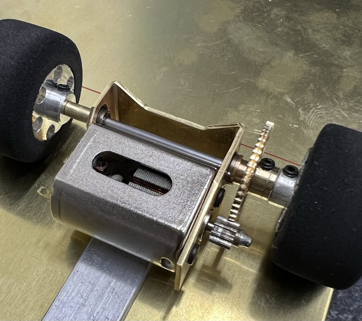

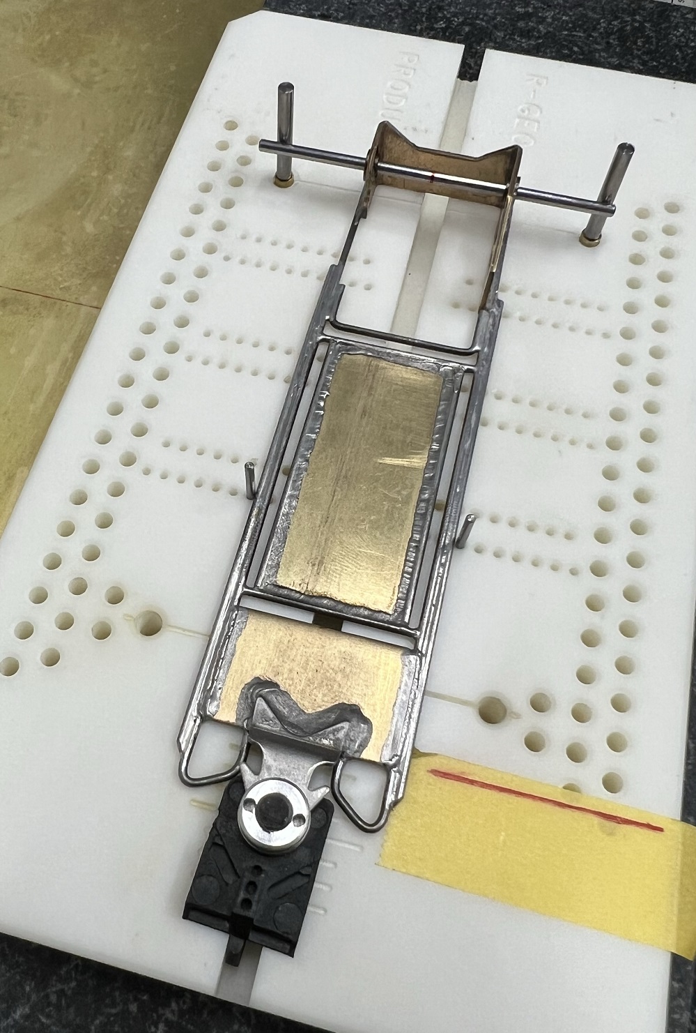

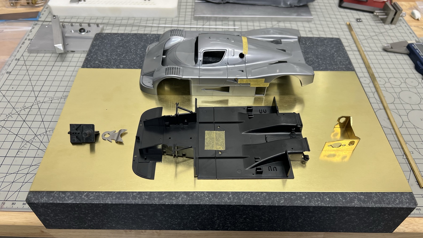

I'm jumping into the deep end... I started the build of my first brass chassis car to race in the D3 Hardbody GroupC / GTP class about 10 days ago.
It's a Tamiya Sauber Mercedes C9 kit that I'll use the body from. I haven't decided if I'll even paint it, I might just add some decals.
This pic I posted in another thread... the start of a concept, in my head.
Here's the progress... I used the lathe to make a custom aluminum spacer to go between the guide and the tongue, and I turned down a brass bushing to make a spacer on the axle.

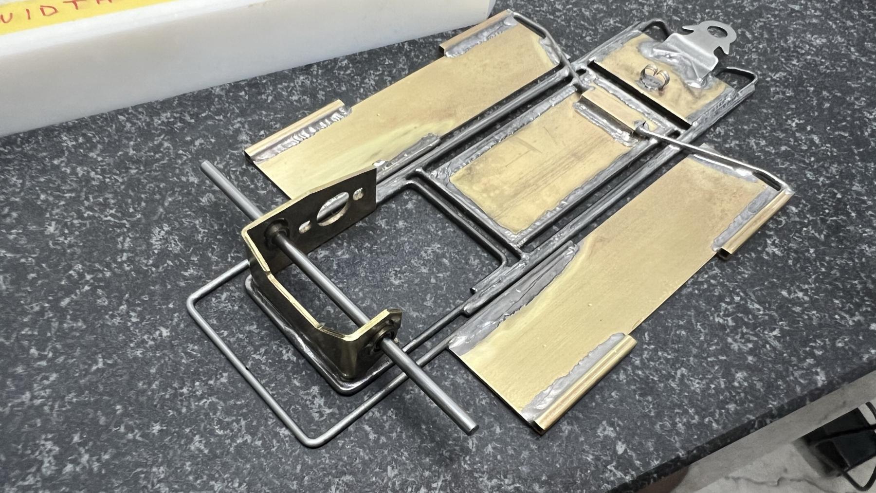

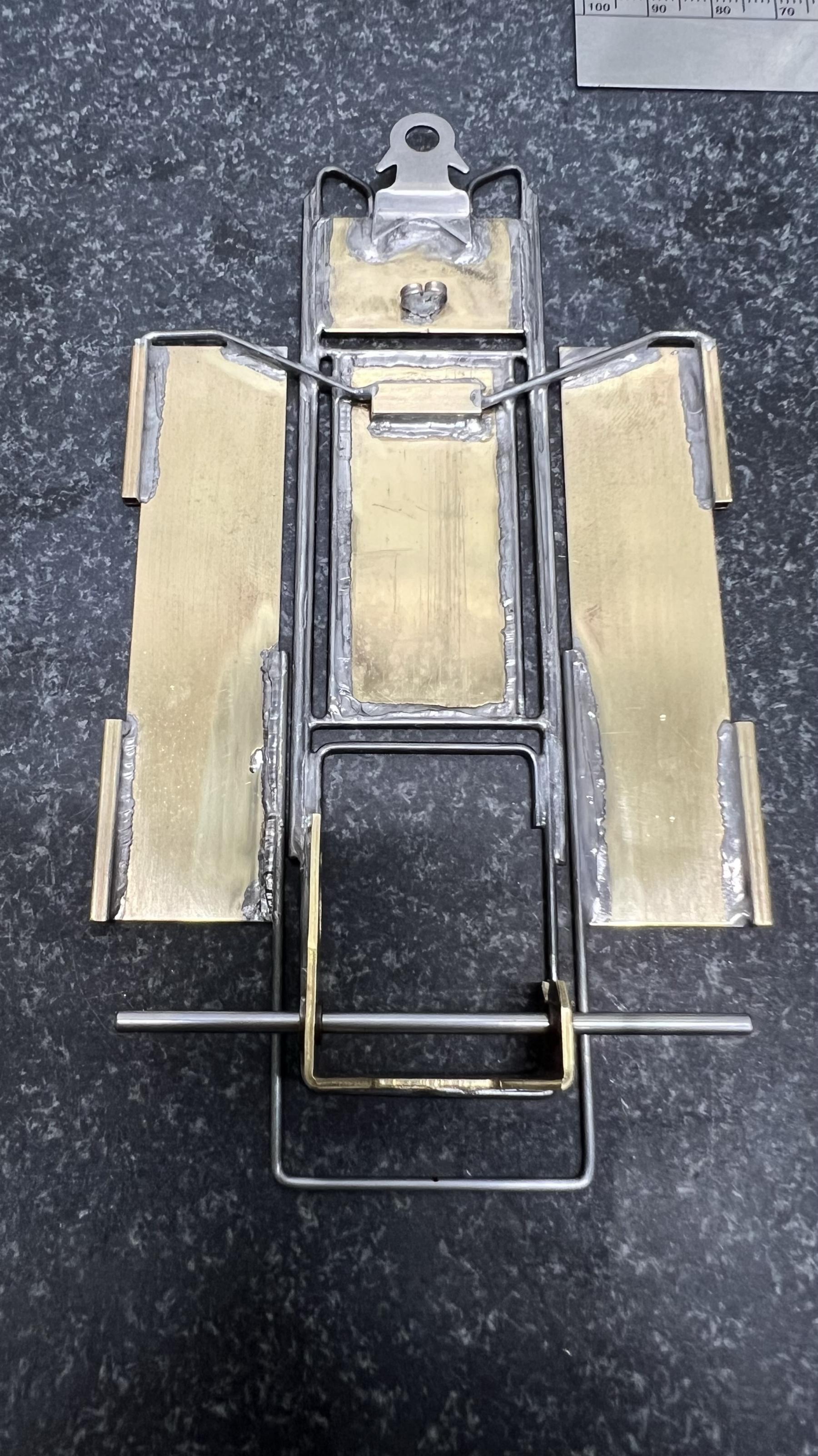

I cut the side pods and I'm at a point where I need to decide how to continue... here's the question: do I put them with the square on the inside or the outside?
and I think I need them to move a tiny bit, not be soldered to the main center part of the chassis, is that correct? I want the weight to be towards the outside of the chassis...
Also, do I make the rear wing and its support an integral part of the chassis or the body?

Hey Dean, you might want to use a different guide tongue, that is really many to go on top of a coined tongue to be a stiffener, not to be used by itself, those are fairly soft.

There are quite a few good ways to mount your side pans to allow a bit of motion. And to describe them properly would take quite a long detailed description. As we all know a picture is worth thousand words so your best bet to understand how to mount your side pans would be to check out this thread, Scratchbuilt chassis gallery right here on Slotblog.  There's a huge number of chassis' (126 pages to be exact) to view the various side pan mounting types.
As for answering your second question, 99% of the builders, and I would think especially with a hardbody car, you would want to make the rear wing part of the body.
For your first scratchbuilt chassis I would say you've done pretty good with decent soldering skills, and it's obvious that you have some good machining skills as well, all a big help when building this kind of chassis.

Did you notice on the chassis that are pan chassis there not a full pan chassis. They have a motor pod built-in that floats like a 1/32 slot.it car.and also they have a guide pod that floats for the guide flag.
That's been the combination for a few years now.
Ken Hill

With the new found intel, I think I'm going to cut the motor pod off and make it float, as well as the guide plate.

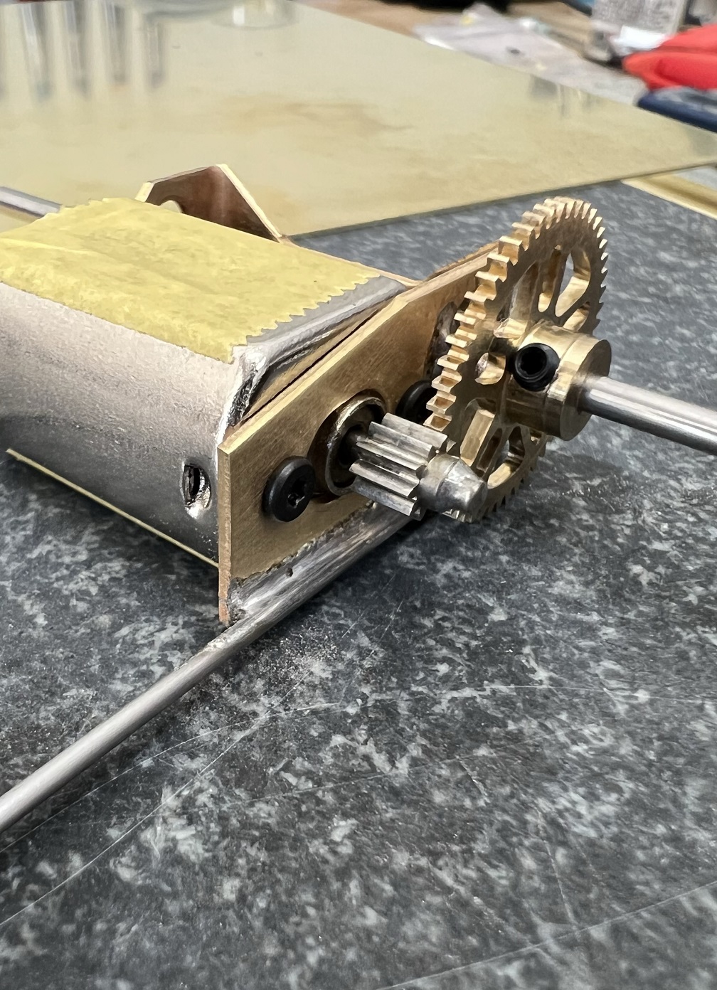

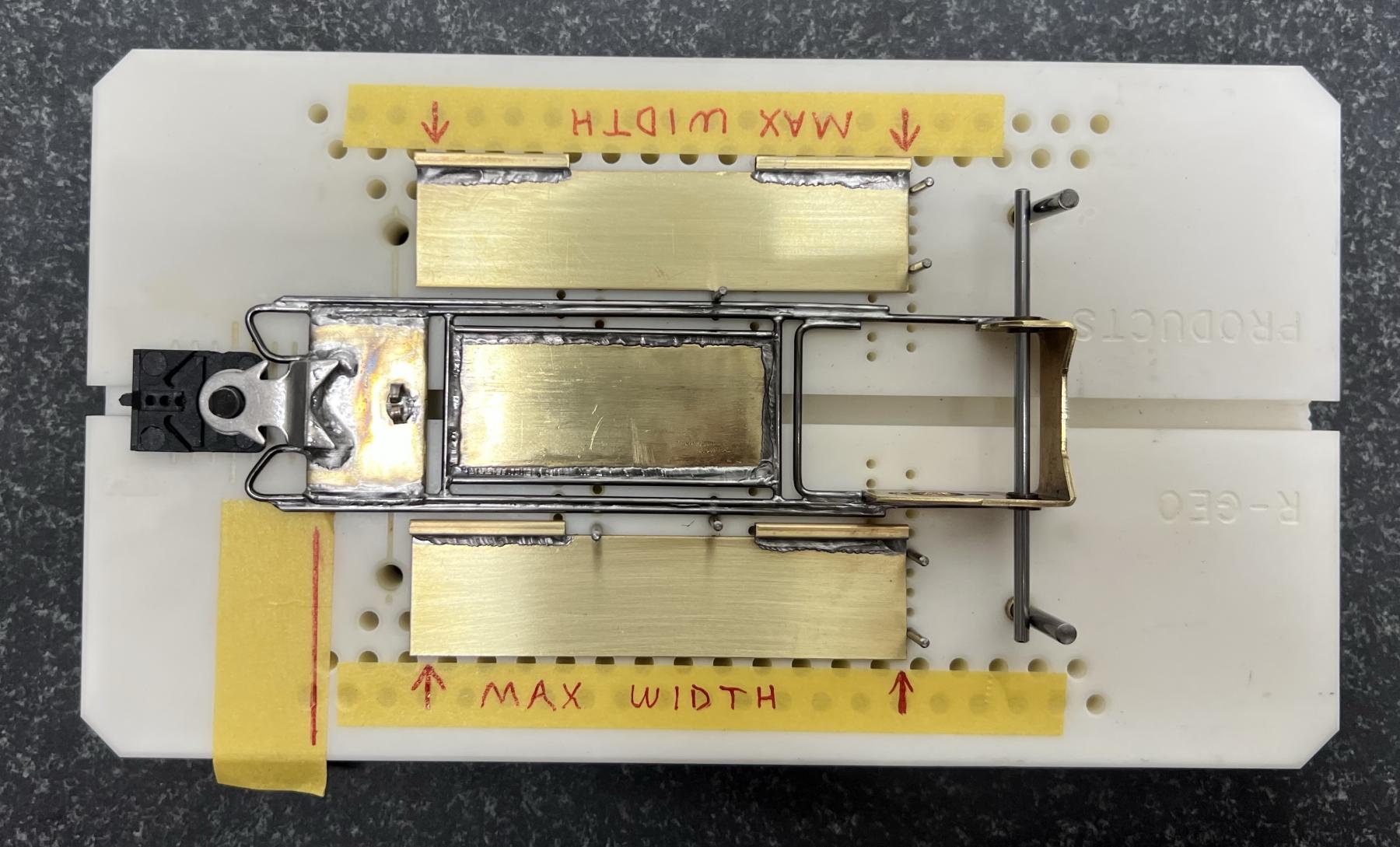

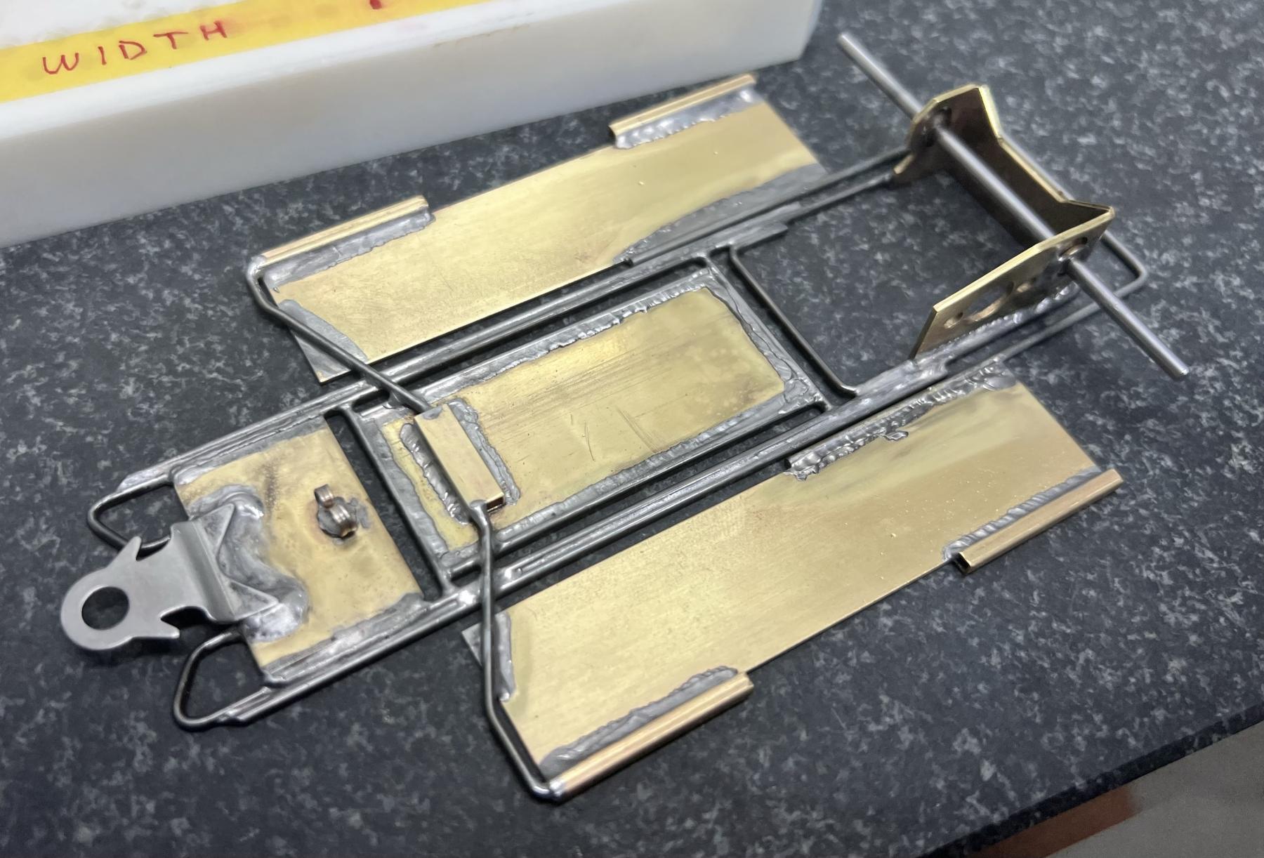

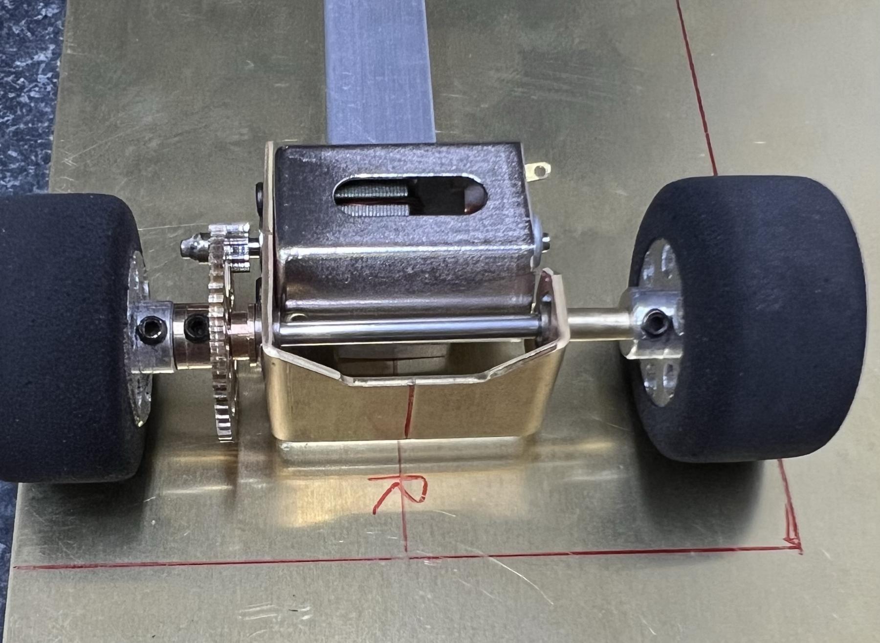

Update... I added the side pods that are structurally part of the center of the chassis. I also added a rear frame that I'll add some thin sheet to, as well as to the motor pod, and add a spring to it at the back. I'll then cut it free and hinge it to the center of the chassis. Then I'll work on making the front have some movement.

Where do you buy the rear spur gear?
Thanks,Ken
Ken Hill
#25 DeanJ
DeanJ
  • 95 posts
  • Joined: 13-March 26
Posted 30 March 2026 - 01:45 PM
From Electric Dreams in LA
