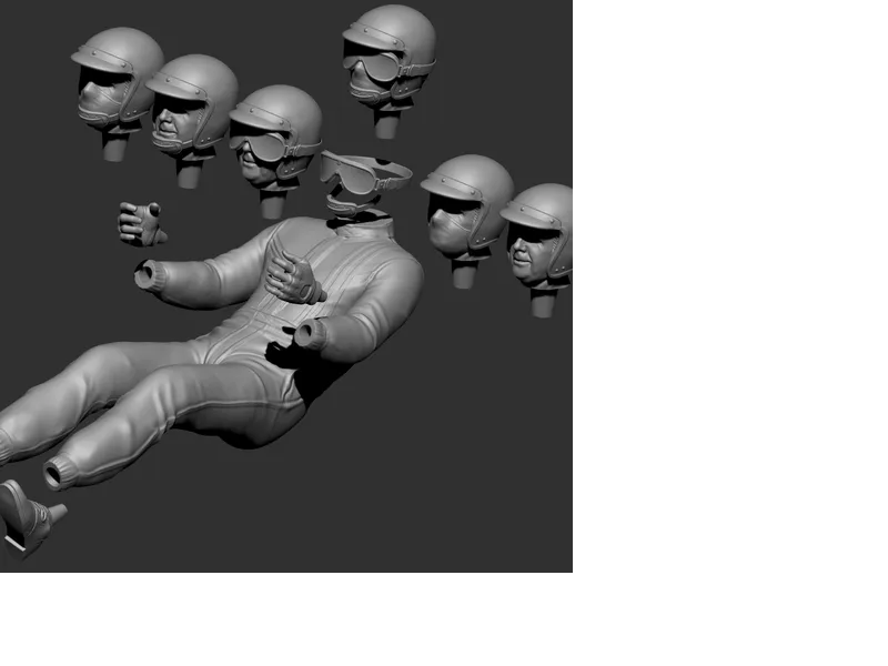

Good options for the helmet too

That is nice Paul. I actually would preferer no helmet in the Bat car,  or at least have that as an option.
I do not understand why he seems to be steering a truck steering wheel, its huge, no?

Yeah I agree about the big wheel but Larry should be able to modify it to bring the arms/hands closer.

So we're literally talking about plastic surgery...  :unknw:
  • NSwanberg and SpeedyNH like this
#81 Martin
  • 4,671 posts
Posted 04 July 2025 - 01:24 PM
I see what you did there Yes, Plastic surgery :laugh2:  you funny man.
Just a little nip and tuck.
I can make cuts under his armpits and bring his hands closer together no problem. :good: But who can print it  :) ?

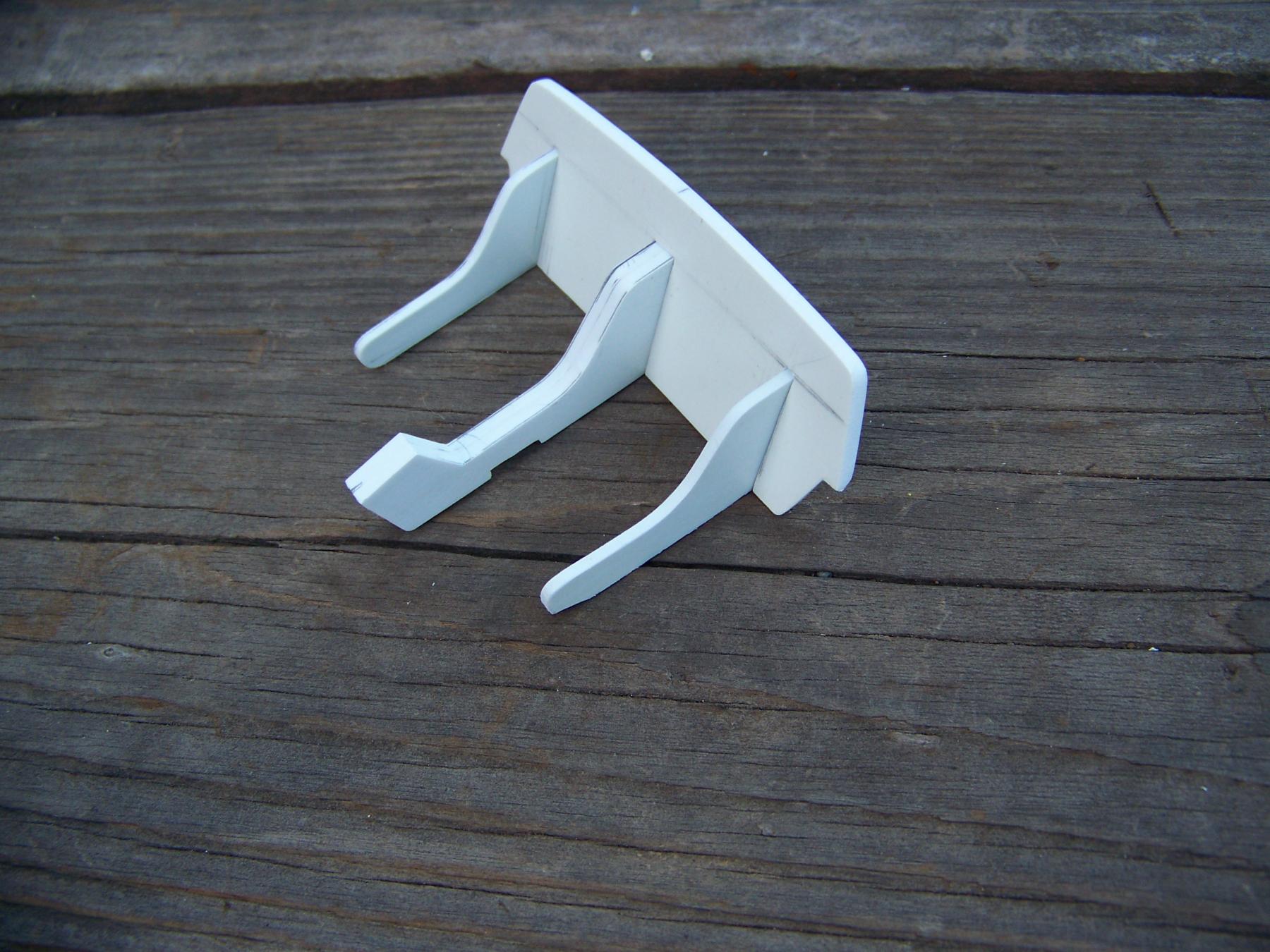

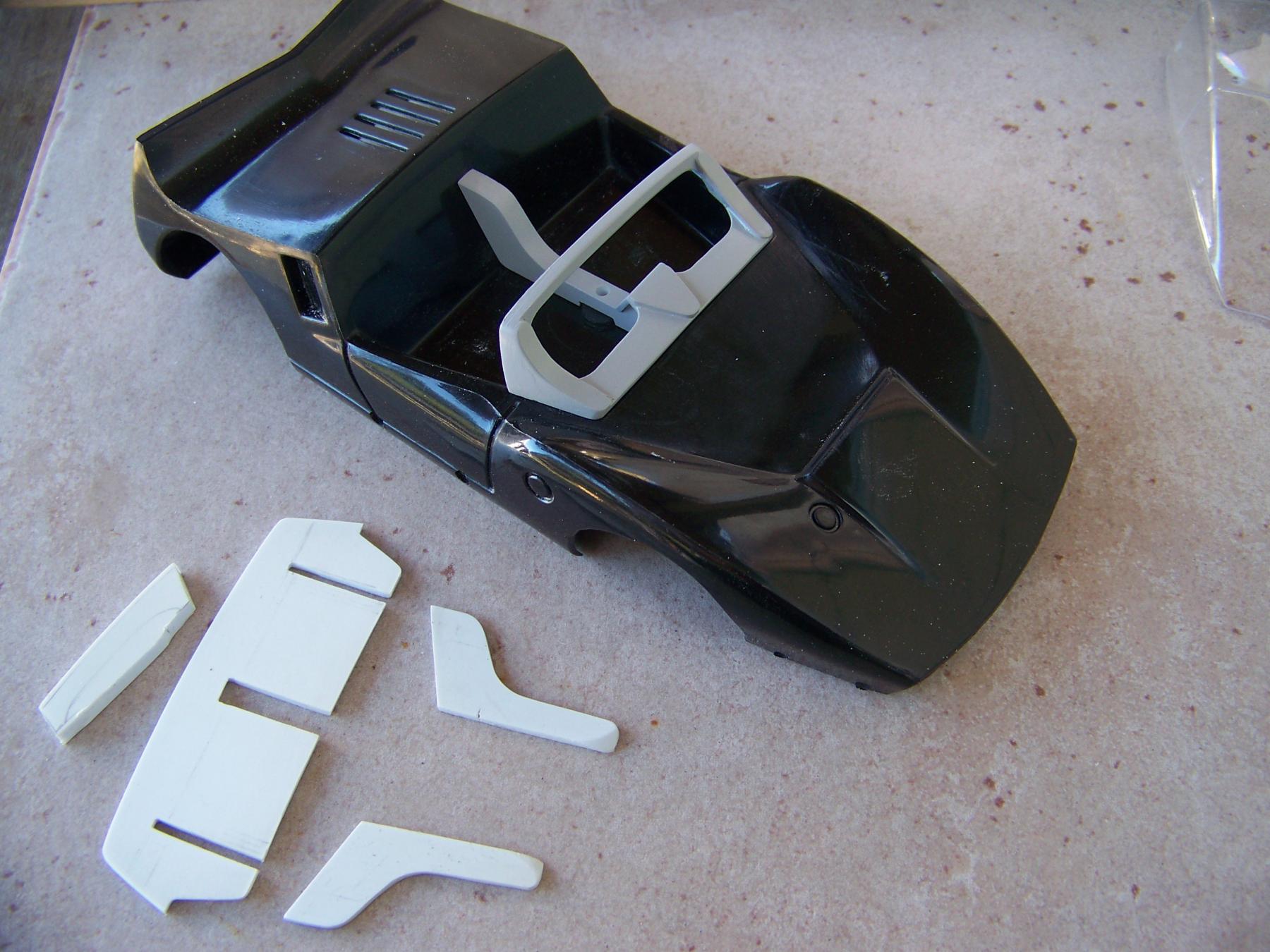

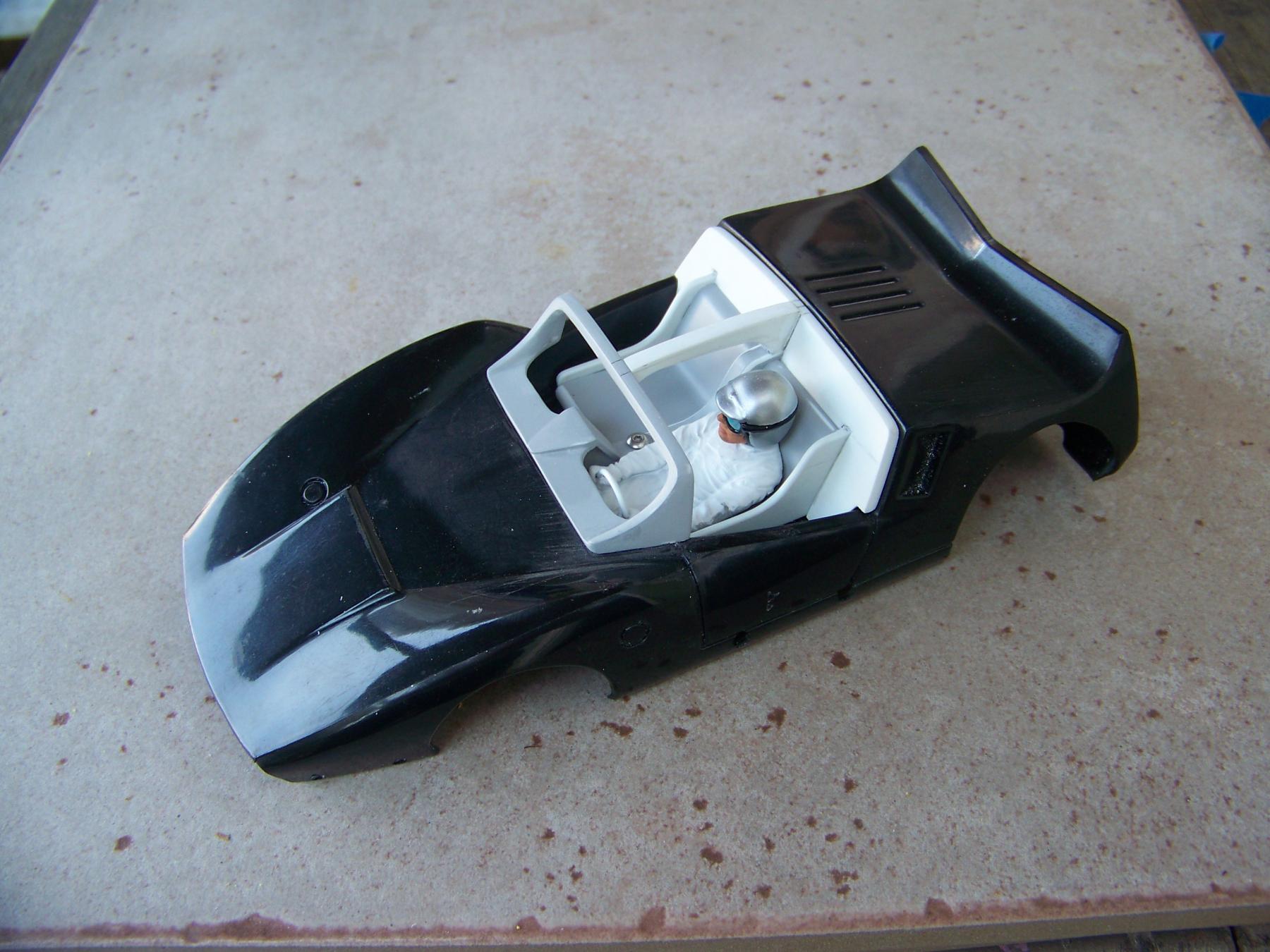

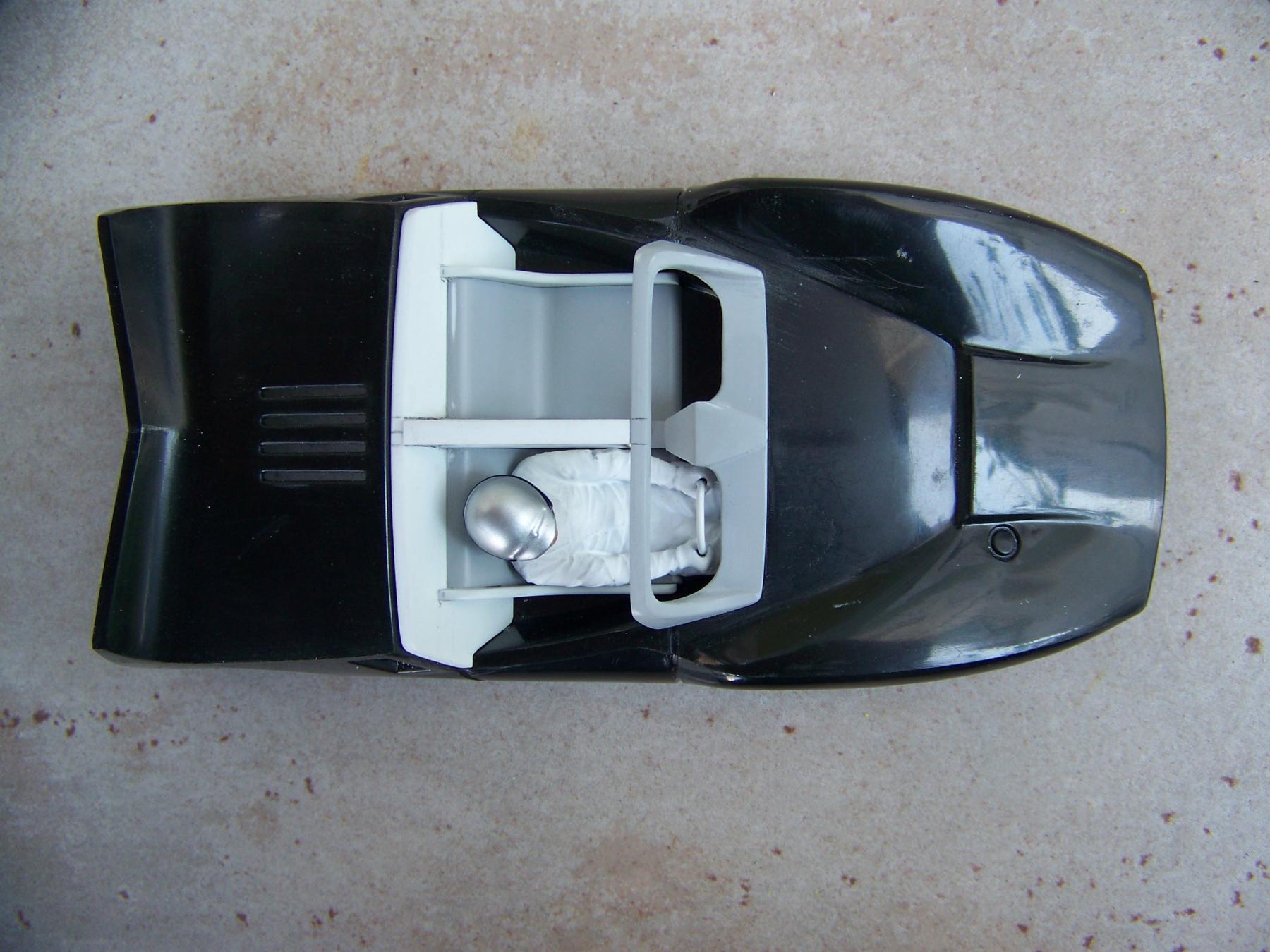

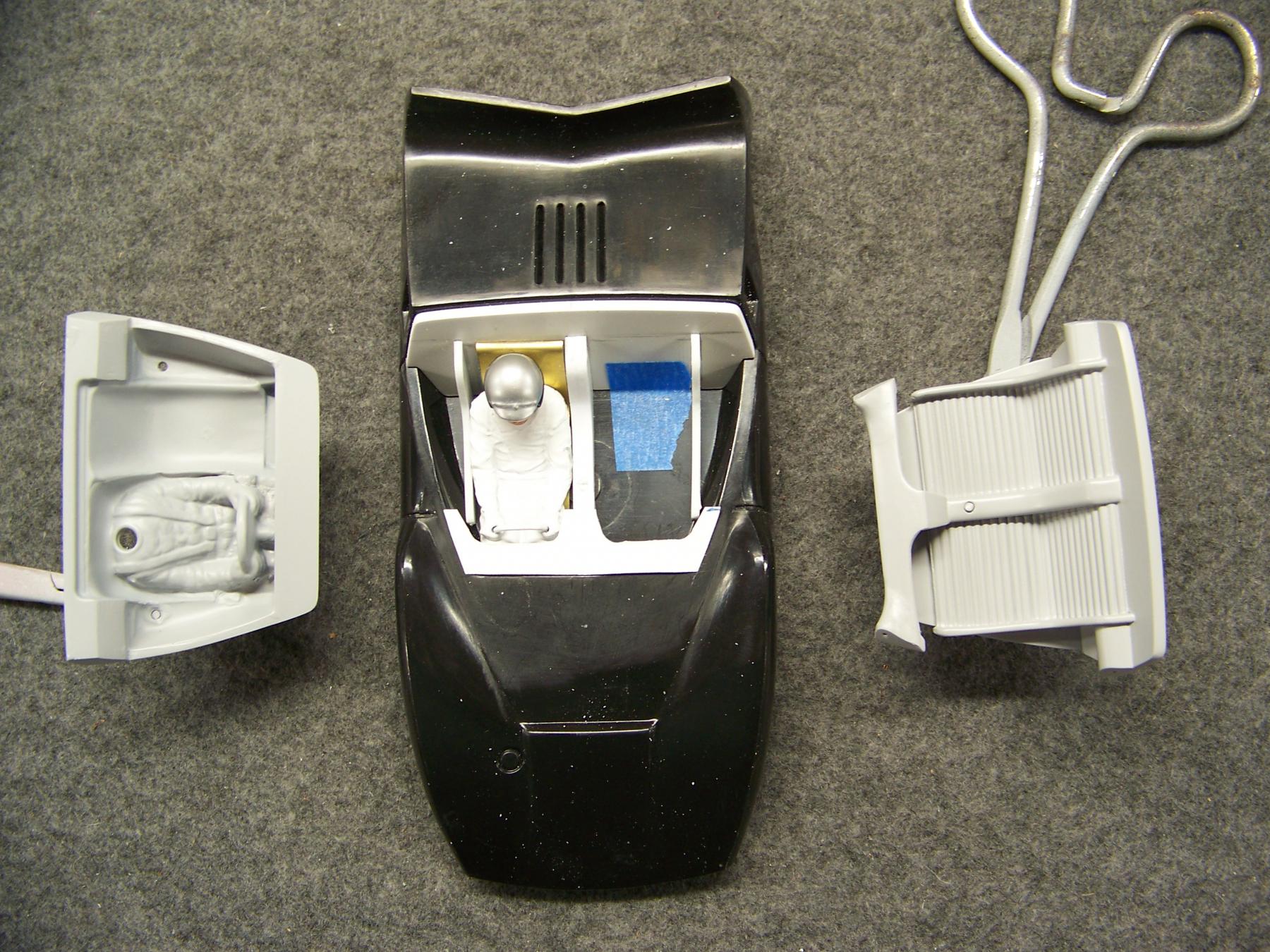

Working on the interiors, I got 2 variations in primer and started on the final parts for the 3D printed model.
The main changes are the full 3D driver is now lower and has more room around the steering wheel. Also the seats will now be smooth so they can be painted different ways. They now the seat bottom is ..080" high and sit directly on the MDC floor as molded.
All the parts indented to be modelled are made in the flat then drawn, so Larry can work his magic and stick them all together in CAD. The top of the dash still in card stock, ready to make in styrene soon.
I was going to cut the front pin mounts completely off as I thought there were just too big. In the end I thought I would give them one more look,I did cut the front mounts to there minimum size. still need a final sanding once the primer is dry.

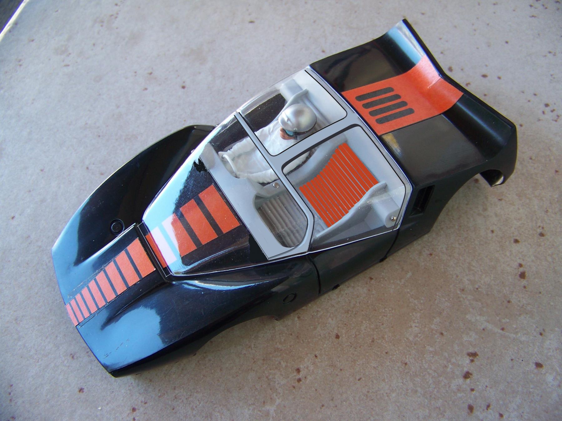

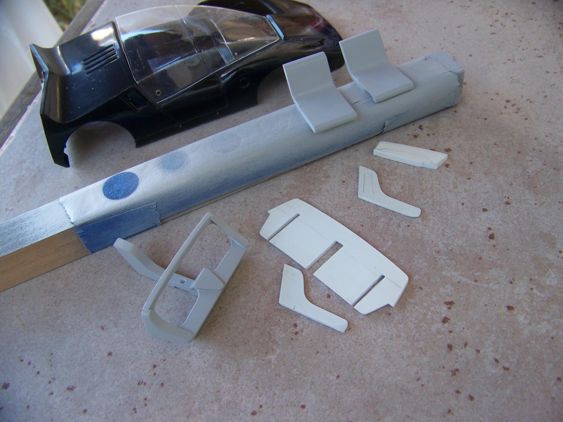

Working on the interior a bit more I wondered what it would look like as a T top? I did it first in photoshop and then set out to do it for real in styrene.
Priming parts help me see what I have and where I need to trim fill or change, its a guide coat really.
This is where it is todate.

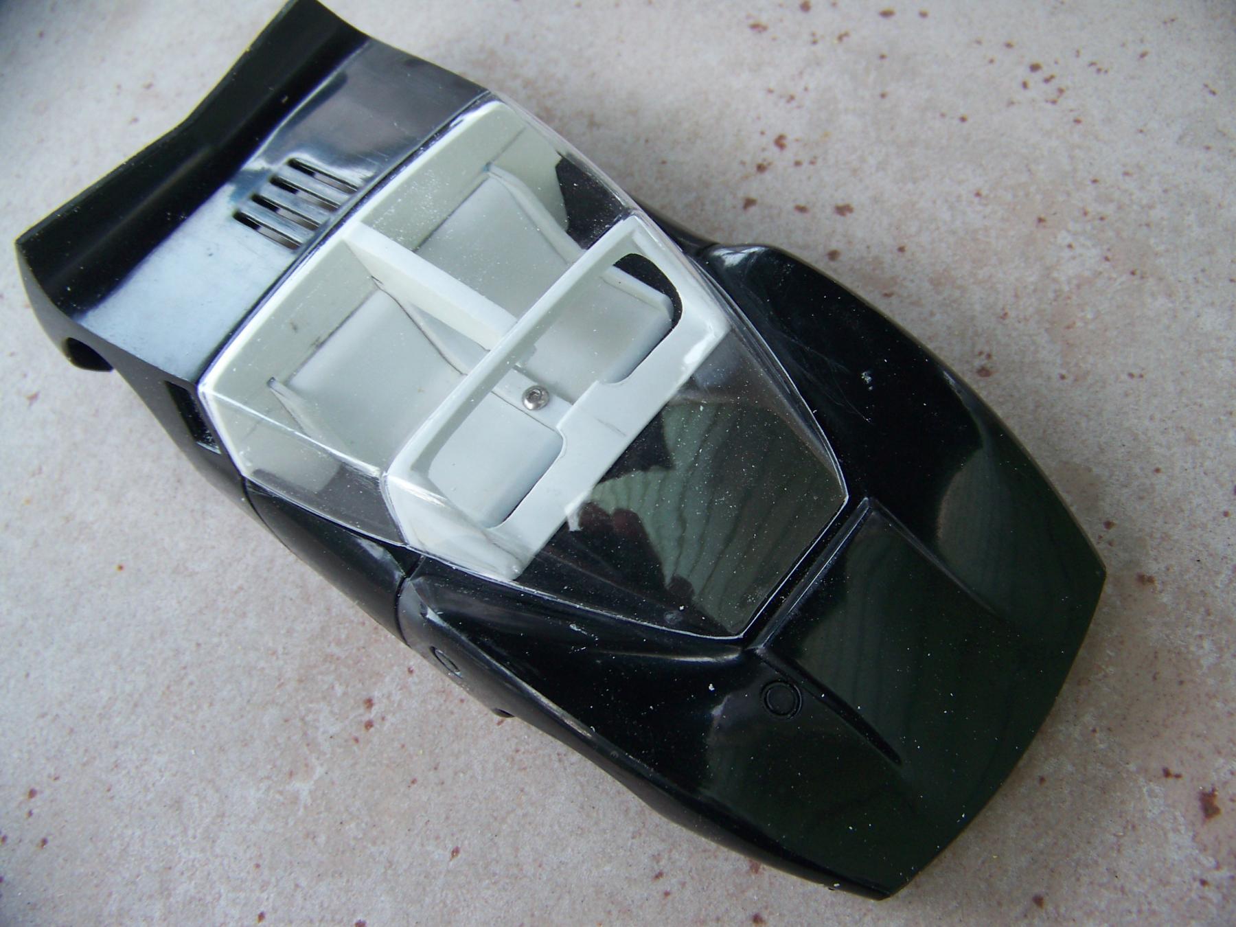

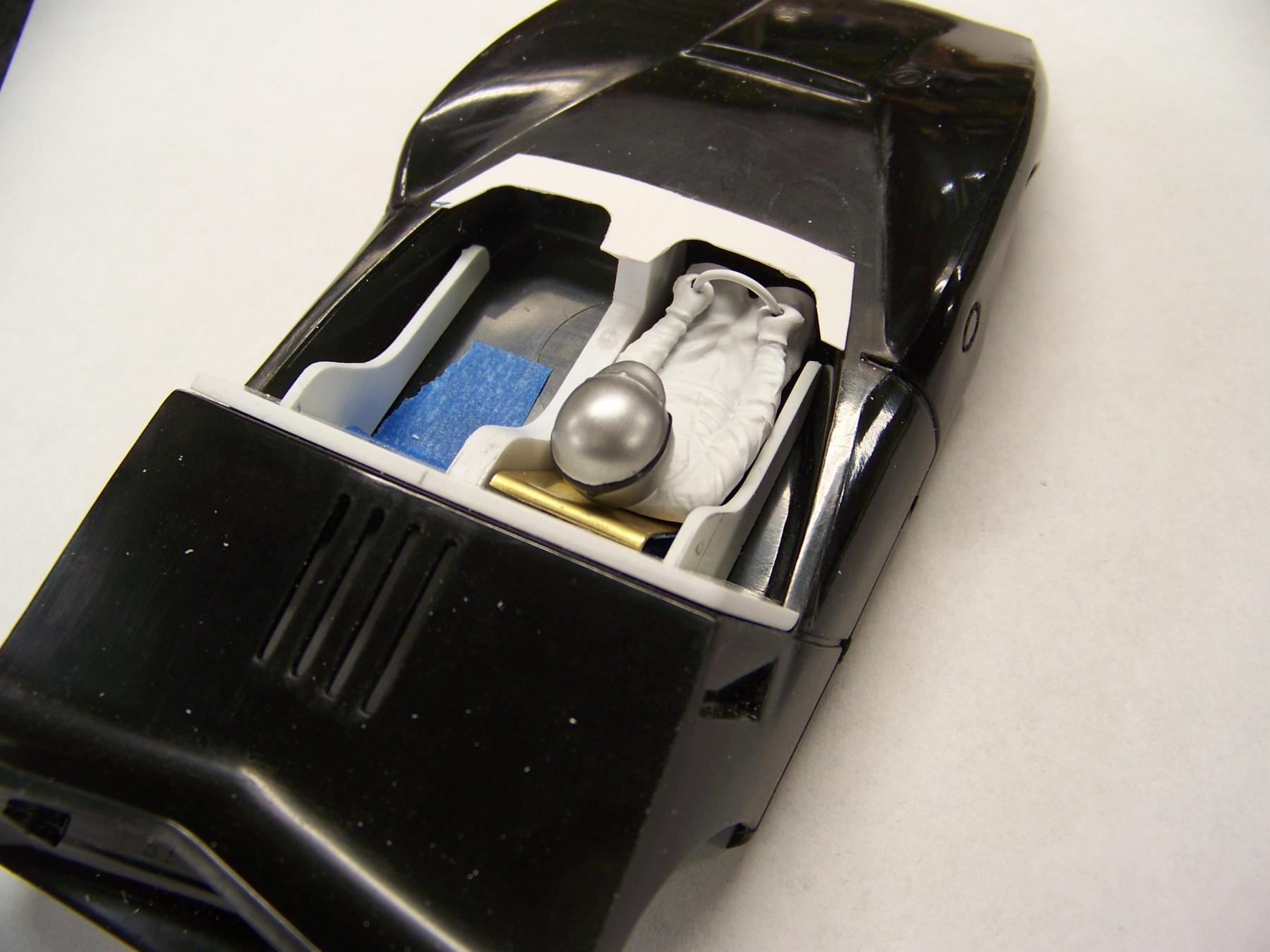

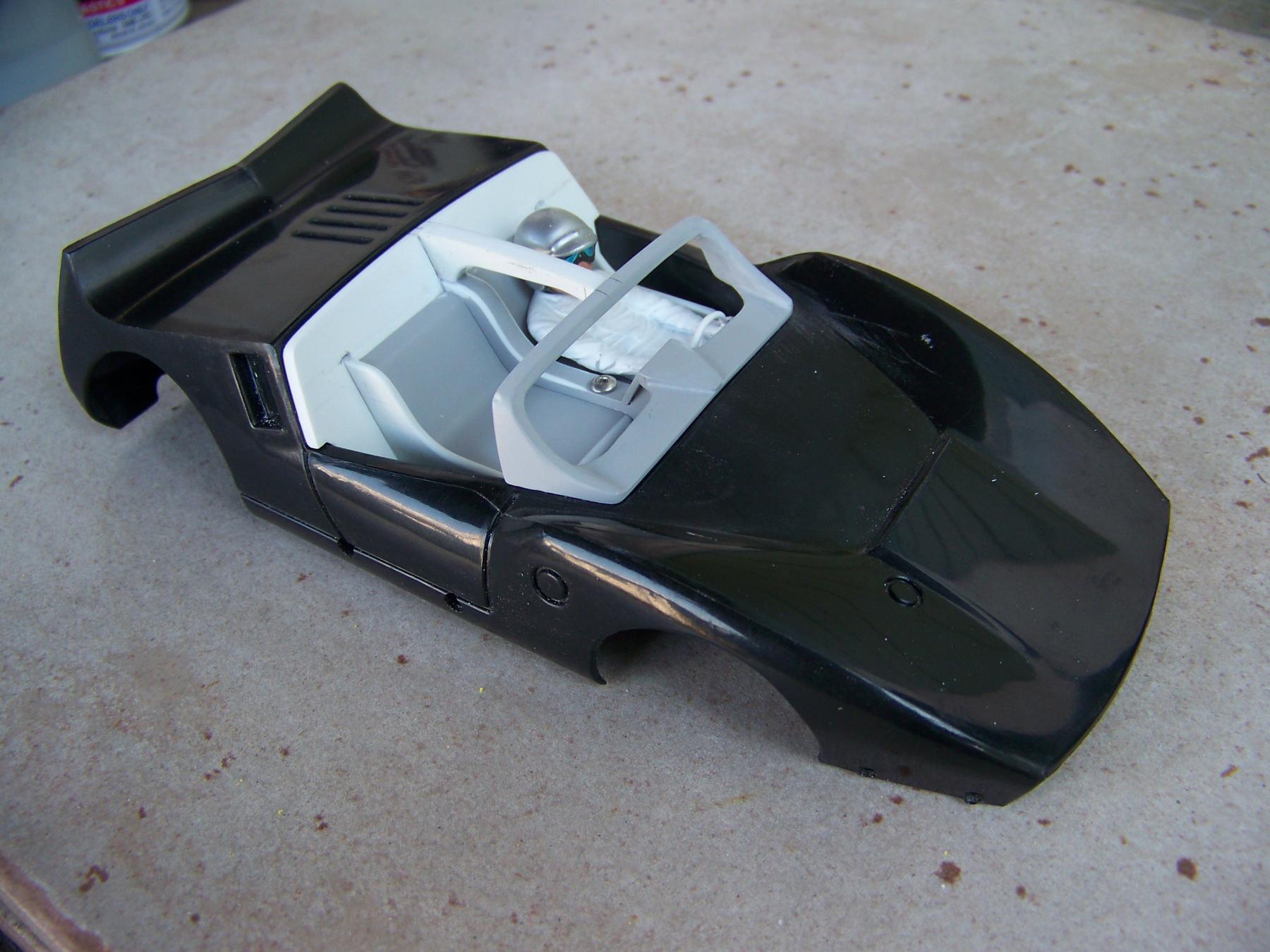

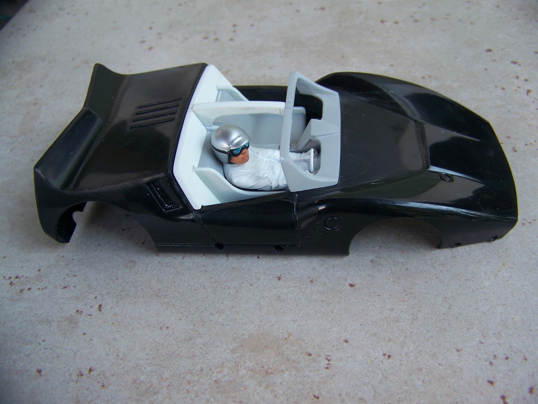

It does not look much different but all parts are now glued and are as one.
We will make this interior with or without the windshield frame and T top. My plan was the have the option of a Gullwing hinging from the T top.
I guess it technically will be called a Batwing not a Gullwing?
Here are the latest pics. There will be a small rib .030" high on the T top to replace the canopy material when cut in half, it will also give a finished look.
  • olescratch, Jaeger Team and Larry Horner like this
